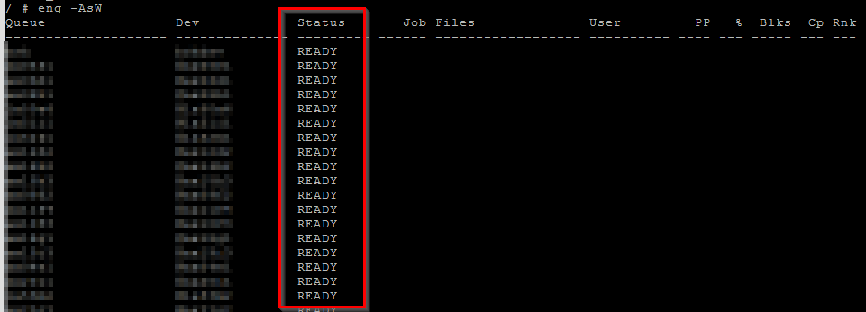

    So, I am successfully using Zabbix Agent for IBM AIX with AIX Template and now I would like to add a new monitor alert and that is when a printer changes from READY status to DOWN instead.
    I have a couple of AIX servers with +150 remote printers per server and of course every now and then some of the printer will go in DOWN status and when that happens I would like to be notified.

    Anyone know how I can use Zabbix for this?

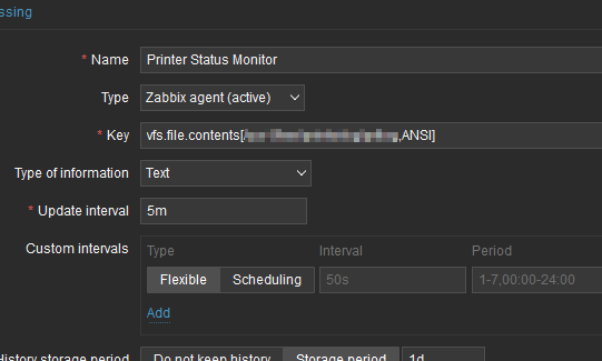

      Solved this by creating a script on each server checking for printers with DOWN status.
      On Zabbix Server I use vfs.file.contents[file,ANSI] with Zabbix agent (active), but if someone have another good solution I am still curious.
