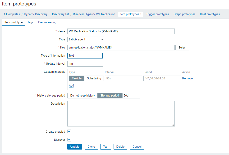

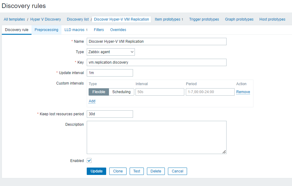

    But I am struggling to make it work. I breifly had it pulling in and I changed something and I was a little discracted and it stopped working.
    Here is what I have so far.
    Here is the discovery rule on my template in our test environment.
    And here is the Item Prototype I made.

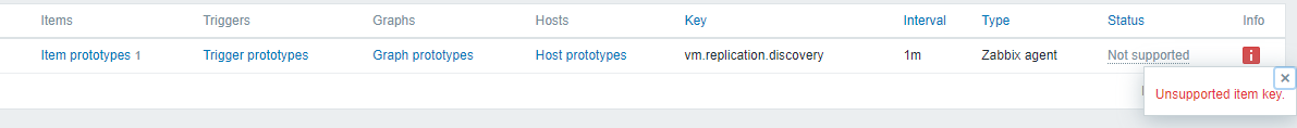

    When I apply the template to the Hypervisor host I am getting the following error.
    This is my first time writing a Discovery Rule from scratch and not modifying or going off of someone elses work so I am a little lost and I know I have messed up somewhere but I cant see where I messed up.
    Can someone help me with this discovery rule.

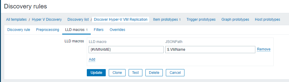

    Hey Luke,
    can you try to change these things? I'm just basing this on my templates (which also took me a while to get right):
    LLD Macro
    {#VMNAME} = $.["VMName"]
    Item Prototype
    Change Type of Information to Text > I'm thinking the "N/A" might cause trouble otherwise​
      • 4996
      But you have nowhere declared the "vm.replication.discovery" key... you only have "vm.replication.status" in your agent config...
      For me it looks like your "vm.replication.status" already returns all the data necessary, so you should maybe call it for discovery and then all the item prototypes should be dependent items, which take data from that main discovery item (preprocessing, jsonpath etc).

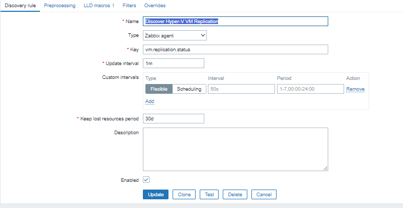

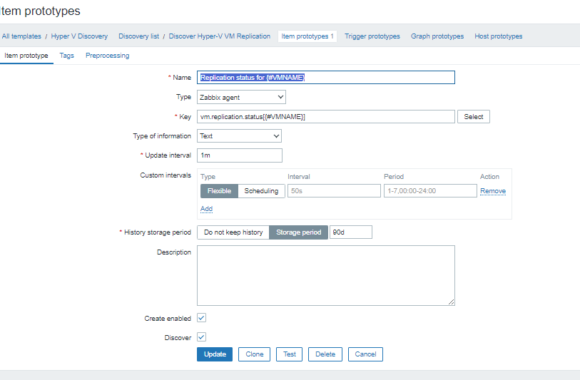

        Okay so I made the Auto discovery rule use "vm.replication.status"
        This is my Item Prototype
        But it is just spitting out this error on the host I apply the template too
        I am not sure what I have done wrong. Both the discovery rule and the Item Protype are using vm.replication status.
        I have tried both the LLD Macro
        {#VMNAME} - $.discovery[*].VMName
        and
        {#VMNAME} - $.VMName
        The data is there but I cant get it to make seperate entries on each VM for
        "ReplicationState":
        "ReplicationMode":
        "ReplicationEnabled":
        "HealthStatus":​
          • 4996
          Item prototypes type should be dependent item, not zabbix agent.. thats for first thing...
          second.. don't use {#VMNAME} as field name in script.. use ordinary "VMName" there ("VMName" = $vm.VMName)... Then your LLD assignment also works.
          third.. item prototype preprocessing... jsonpath and "$.[?(@.VMName == "{#VMNAME}")].ReplicationState.first()" for example... that should return ReplicationState value for each VM, when it iterates over data...
          And then you can create similar prototypes for other 3 things also...
          Have not done it for a while.. And it has always given me headaches..

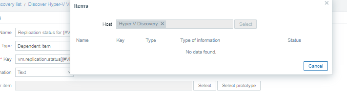

            Thank you for the advice. So i have updated my script.
            I am trying to make my Item Prototype dependant on the Auto-discovery rule however
            Click image for larger version  Name:	image.png Views:	0 Size:	19.2 KB ID:	468271
            Nothing shows up I cant selet my discovery rule as the master item.​
            Edit: Just realised I need a standard item to be the master not the discovery rule

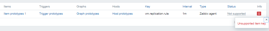

              Now I re-created my discovery rule with the key vm.replication.rule because I can not have 2x items with the same key.
              Finally I made a dependant item prototype dependant on the item using vm.replication.status with the key vm.replication.status[{#VMNAME}] and the item protoype has a json preprocessing step of "$.[?(@.VMName == "{#VMNAME}")].ReplicationState.first()" and an LLD macro of {#VMNAME} - $.discovery[*].VMName.
              and I am still getting Unsupported Item Key
                • 4996
                Discovery key -> vm.replication.status
                Key is the thing that is asked from agent, as you have only "vm.replication.status" defined there, then you need to use that...
                EDIT: oh wait.. if you have master item and your discovery uses that data also, then change discovery type also to "dependent"....

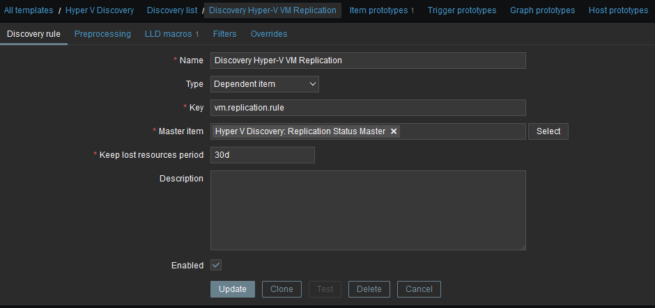

                • SanMonitor
                  • Aug 2022
                  • 49
                  Originally posted by LukeAB93UK
                  Right so.
                  I have a master item using the key "vm.replication.status". this is working and pulling in the raw output.
                  Click image for larger version  Name:	image.png Views:	2 Size:	37.1 KB ID:	468273​
                  Click image for larger version  Name:	image.png Views:	2 Size:	11.9 KB ID:	468274​
                  Hey Luke,
                  The last screenshot is of your discovery rule with key vm.replication.rule? The Type here should be dependent item, not Zabbix agent.
                  The reason you're getting the error is because the key vm.replication.rule is unknown to the Zabbix Agent.
                  An overview:
                  Template has an item with key vm.replication.status that returns JSON, type Zabbix Agent.
                  Then you should have a discovery rule type Dependent item (on the previously created item) with your key vm.replication.rule.
                  ​Under this you can create your item prototype, also type dependent.

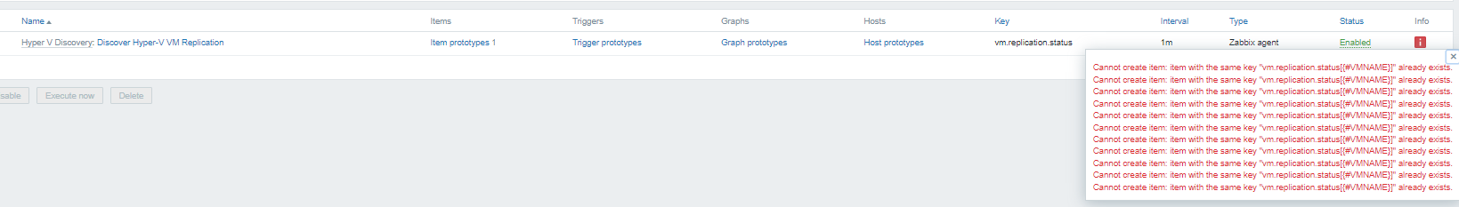

                  • LukeAB93UK
                    Zabbix Certified Specialist
                    • Jun 2023
                    • 72
                    Originally posted by SanMonitor
                    Hey Luke,
                    An overview:
                    So I made my Discovery rule a dependant item on the Item in the template.
                    I am still getting this error. "Cannot create item: item with the same key "vm.replication.status[{#VMNAME}]" already exists."
                    Here are my configuration screenshots. I know I am going wrong somewhere but I cant pin point where.
                      Master Item
                      Click image for larger version  Name:	image.png Views:	0 Size:	27.2 KB ID:	468283​
                      Discovery Rule
                      Click image for larger version  Name:	image.png Views:	0 Size:	23.5 KB ID:	468284​​
                      Click image for larger version  Name:	image.png Views:	0 Size:	16.9 KB ID:	468285​
                      Item Protoype​
                      ​Click image for larger version  Name:	image.png Views:	0 Size:	35.0 KB ID:	468286​

                        • xavigray
                          • Nov 2024
                          I have tried to replicate your process, but every time I have the same problem when assigning my template to a host.> This problem "Cannot create item: item with the same key "vm.replication.status[{#VMNAME}]" already exists."
                          I would like to put here some print-screens of how I was building, I don't know if I missed any steps.
                          I tried to fix it myself, but I'm still a newbie with zabbix and I was stuck with this error fighting with it all day, I already deleted my discovery rule/item several times :/
