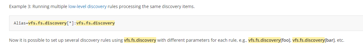

    Hey Robert,
    I have no experience with it myself but it seems that you can define different aliases in the zabbix config file:
    6 Zabbix agent 2 (Windows)​​
