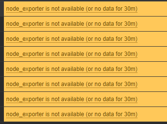

    Dear All,
    i'm using zabbix version 6.4.4 and i would like to monitoring linux server with template OS linux by prom.
    i have another zabbix server 5.0 and monitoring normally but in new version (6.4.4) i can not monitoring
    So i have 2 question:
    • Monitoring Linux server template need to install node_exporter like prometheus ?
    Click image for larger version  Name:	image.png Views:	0 Size:	17.7 KB ID:	468394
    After add template for host, i have this issue: port 9100 after 0 ms: Connection refused.
    I mean, how can to use prom template ? we must to install node_exporter & open port 9100 ?
    Thanks​
  • Atsushi
    • Aug 2013
    • 2028
    What have you installed on the server you want to monitor? Are you a Zabbix agent? Or is it node_exporter?
    If you want to install Zabbix agent and monitor it, the template you use is different.
    If you want to monitor using Prometheus' node_exporter, install node_exporter. Zabbix agent installation is not required.​

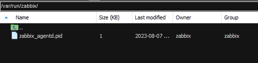

          i have another issue about zabbix agent 2 , can i ask here or create new post ?
          in my oracle linux 6 server , i installed zabbix agent 6.4.4 & it's running normally but when installed zabbix agent 2 , i can not start it.
          I try to disable zabbix agent to give port 10050 for zabbix agent 2 but it's still can not running.
          when check logs: cannot start agent: listen unix /run/zabbix/agent.sock: bind: no such file or directory
          Zabbix Agent 2 stopped. (6.4.4)
          Many Thanks
          • Atsushi
            • Aug 2013
            • 2028
            Make sure the directory /run/zabbix exists on the server where you want to run Zabbix agent 2. If not, please create one.
            # ls -ld /run/zabbix/
            drwxr-xr-x 2 zabbix zabbix 240 7月 28 15:42 /run/zabbix/
            It should be created automatically if you are using the package and installed successfully, so you usually don't need to create it manually.

              I can run zabbix agent but can not with agent 2 :
              in my server have dir /var/run/zabbix already but i think my issue is zabbix agent 2 can not create file .pid automatically.
