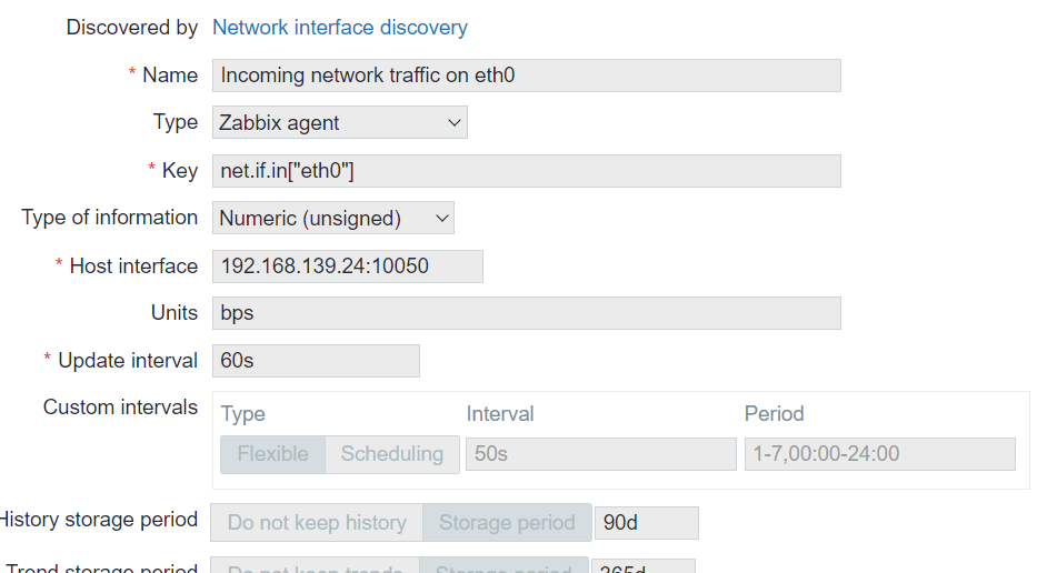

    1. item config

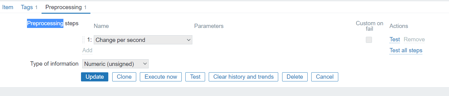

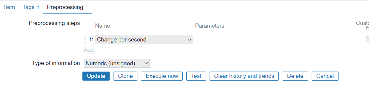

    2. preprcess config

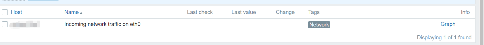

    4. problem : there is no data on last data ​

    who can help on this thanks
    • ISiroshtan
      • Nov 2019
      • 324
      Zabbix bug. Update to 6.0.16
