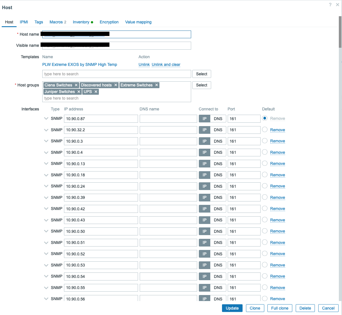

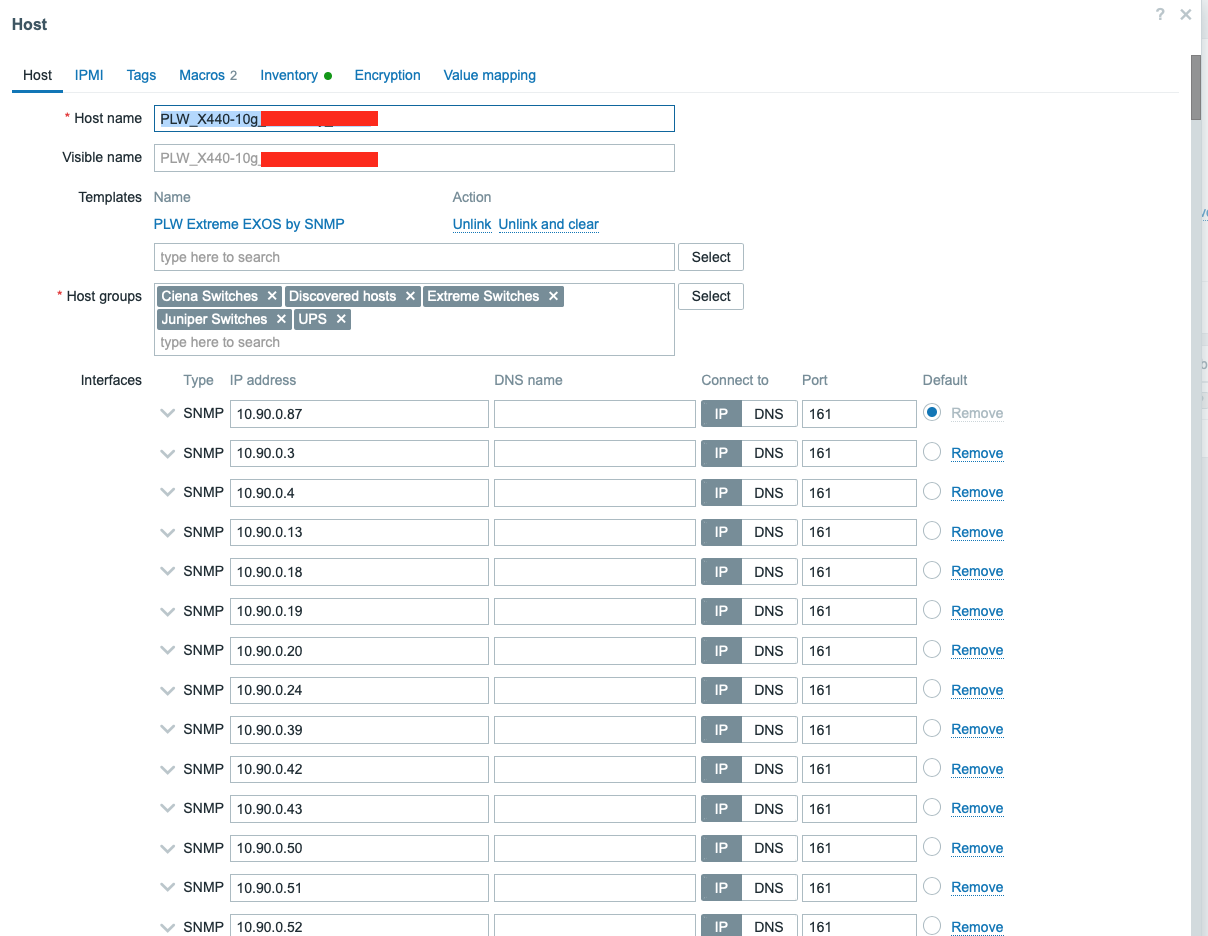

    My issue now is that I have a couple of switches (right now one switch only, but I seen 2-3 switches do that), and they end up with a lot of IP addresses. I assume they came in via discovery. Hundreds of IP addresses. These IP's are valid on my n network, but belong to other switches. Not sure how or why. Here a picture of what I mean, see all those IP's, there is another 100 or so if I scroll down:

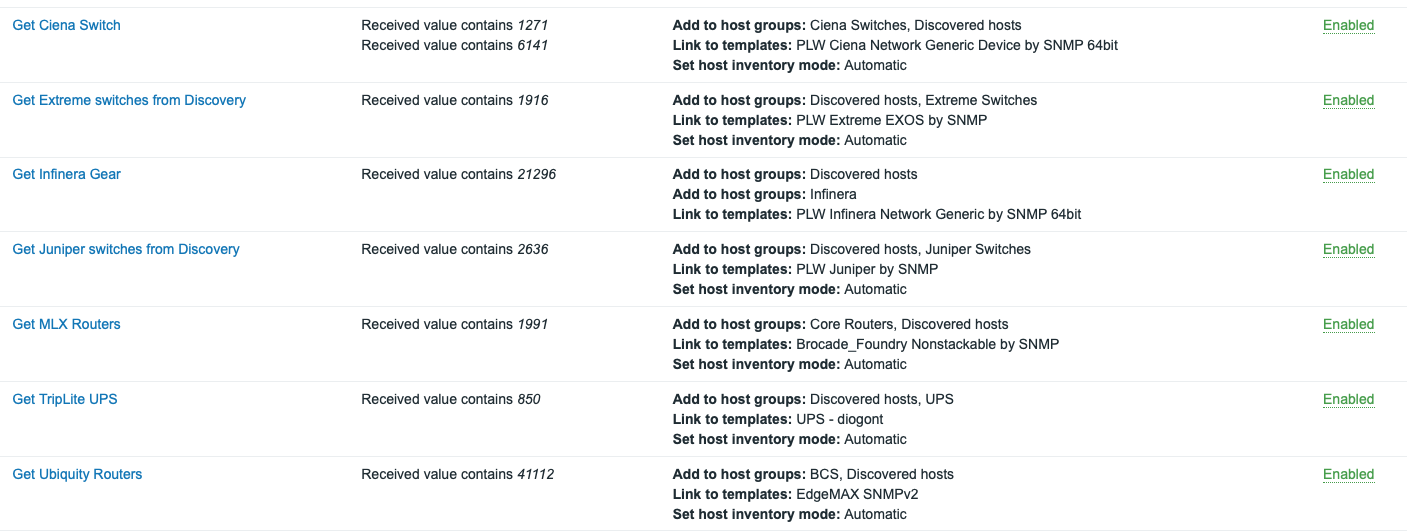

    And to complete the picture, here is my discovery actions. Basically I look at the value received for the Enterprise number in sysObjectID and depending on what I find there, I apply a certain template.

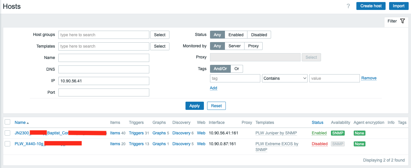

            Now, those three sample IP addresses I pulled randomly do exists in Zabbix with the correct host as well. So, if I search for 10.90.56.41 for example under Data Collection -> Hosts, Zabbix will list the correct host as well as that host that pulls in 100+ IP addresses:
            Click image for larger version  Name:	Screen Shot 2023-09-21 at 11.17.48 AM.png Views:	4 Size:	94.9 KB ID:	470816
            Here a picture of that host record that has 100+ IPs associated, notice the scroll bar on the right, it is small so you can imagine how many IP's are there. And it is not just of the discovery subnets that IP addresses are attributed to this host, but across all subnets I discover. I "cleaned it up" and the last discovery just added IP's back to that host. Weird.
            Click image for larger version  Name:	Screen Shot 2023-09-21 at 11.05.30 AM.png Views:	4 Size:	144.8 KB ID:	470815
