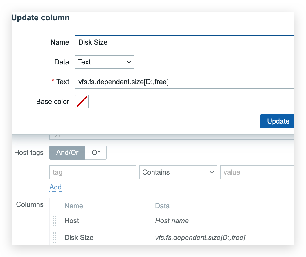

    Wanting dashboard widget to list all disks on multiple windows servers, to iterate through all the drives attached to server and display them in a widget.
    C Drive works fine, extra drives have different letters on different servers, some are F some M some U etc.
    I tried vfs.fs.size[{#FSNAME},free] but get no data.
    Is there a way to iterate through attached disks - drives?​

    You can use Top hosts in widget type and select host group and add Host as 1st column and other disks are as 2nd, 3rd and so on.

    Something like this vijayk?
    • vijayk
      • May 2023
      • 305
      Yes, perfect.

        Thanks, wondering if there is a way to use disk number variable if that exists in vfs.fs.dependent.size{disk1} or similar macro?
        (bit of a newb at this more advanced stuff)

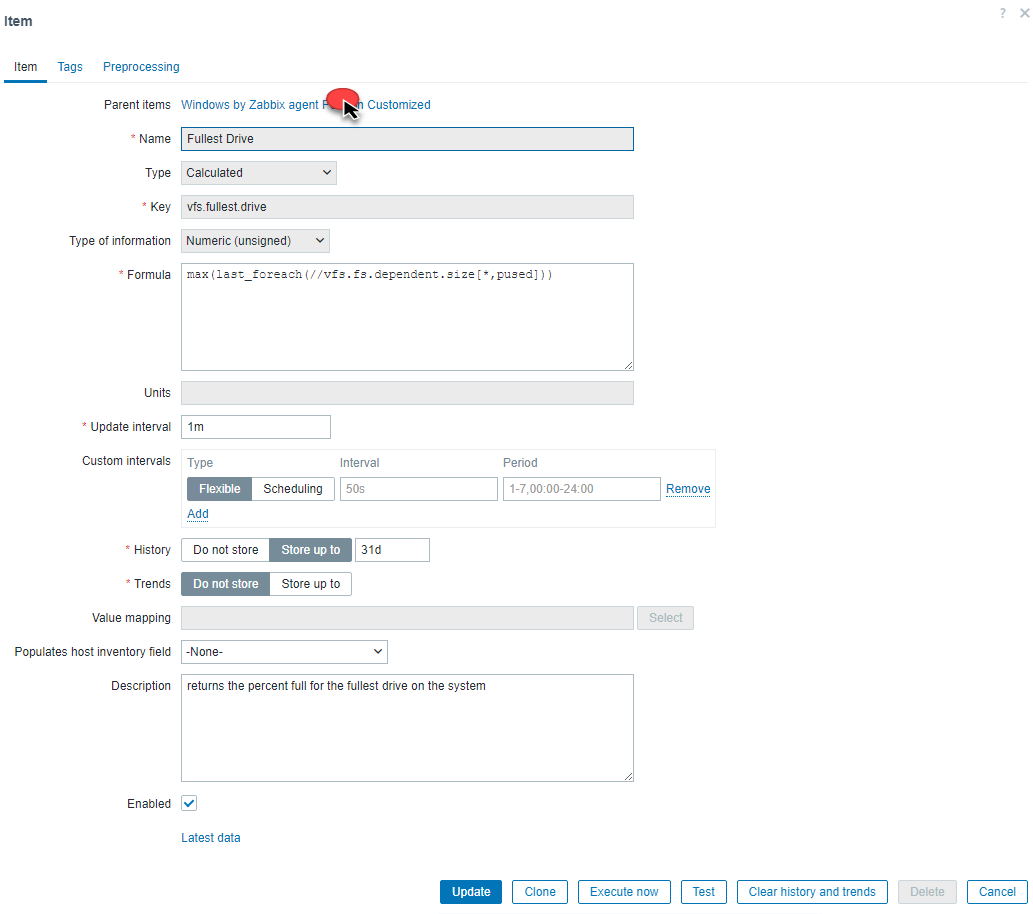

      I also need to know if there's a way to have monitoring dashboard show a calculated item that shows the most full disk of all found disks on the server in question.
      I.e. if a server has disks with utilizations C at 40%, D at 24%, E at 76%, F at 1% and G at 100%, how to get the dashboard column for disk space utilization to reflect the maximum utilized disk, which in this example would be G, so it should show a 100% value on the column data. Because most servers may only have C, or C and D disks.
      Edit:
      Nvm I figured it out
      Formula for the Calculated Item under my custom windows template:
      max(last_foreach(//vfs.fs.dependent.size[*,pused]))

                tko, you need to create a new calculated item. (ideally in a template that you could apply to a group of hosts).
                but to test, you can create a new item on one specific host.

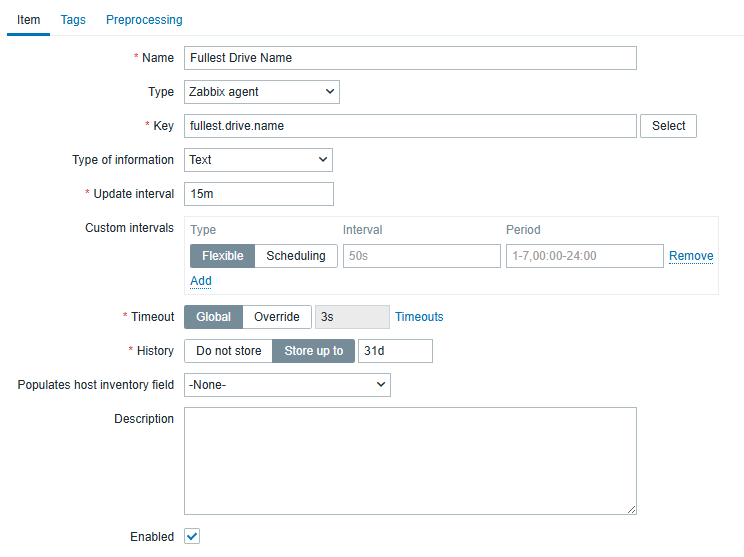

                  Thanks, i have this working, it shows the drive with the most used space - However Is there a way to include the volume name and drive letter (windows) / linux device (e.g. sda1)?
                  • paulb007
                    • May 2025
                    OK - I have a work around for now.
                    Linux
                    Create a script (e.g., /etc/zabbix/fullest_drive.sh)
                    #!/bin/bash
                    # Use the df command to list disk usage, then find the fullest disk.
                    # Adjust the command as necessary if your environment or output format is different.
                    df -P | awk 'NR>1 {print $5 " " $6}' | sed 's/%//g' | sort -nr | head -1 | awk '{print $2}'
                    Making the script executable
                    chmod +x /etc/zabbix/fullest_drive.sh
                    Add a custom user parameter in your Zabbix agent configuration, mine is here /etc/zabbix/zabbix_agentd.conf and I put the parameter at the end
                    UserParameter=fullest.drive.name,/etx/zabbix/fullest_drive.sh
                    Restart the agent
                    Zabbix frontend, create a new item - I added mine to the template Linux by Zabbix agent

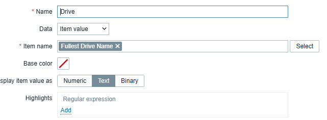

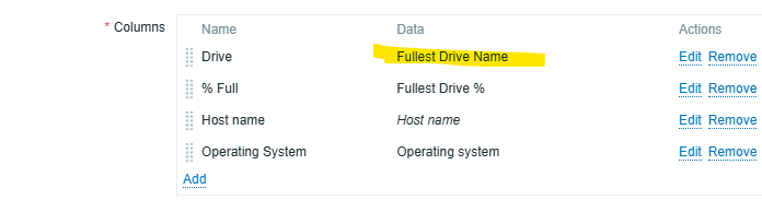

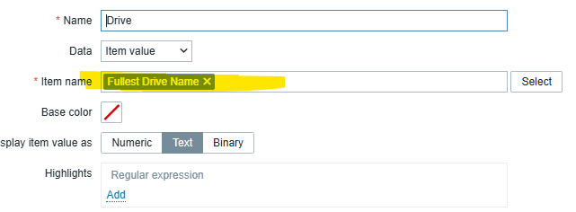

                    Adding to the dashboard
ID:	503075 Click image for larger version
