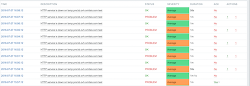

    Hi!
    Im trying to understand why this trigger does not work as I want. With current expression trigger change their status all time from ok to problem, problem to ok, ok to problem. Meanwhile the status of HTTP service is down I do not understand why the trigger status is jumping all the time.
    I think the expression is pretty simple, so why is not working properly?
    My zabbix version is 3.X by the way.
    Any ideas?
