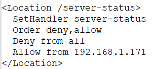

    In my httpd.conf file, I have added the following lines at bottom is as shown below
    in folder /etc/httpd/conf.d, I have the my_website_name.conf and here also i ve added the same lines

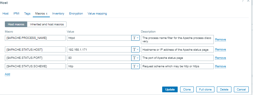

    I am using Apache by zabbix agent template with settings as below
    pls guide me in this regard​​

          So should i be modifying code like this?
          <Location "/server-status">
          SetHand1er server-status
          Order deny, allow
          Deny from all
          Allow from 127.0.0.1
          </Location>​​

                I tested the modern access control syntax
                In my httpd.conf file I've added
                &lt;Location "/server-status"&gt;
                SetHandler server-status
                Require all denied
                Require ip 127.0.0.1 192.168.1.171
                &lt;/Location&gt;
                ExtendedStatus On
                TraceEnable Off
                ServerName 127.0.0.1​
