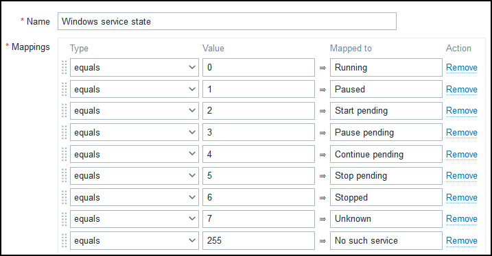

    You have to define the "Thresholds" in item widget. If you are taking about Windows service then thresholds value are as below.

  • vijayk
    • May 2023
    • 305
    Yes, it is available in 6.0.
    Please check with below screenshot.
    Please refer the link. https://www.zabbix.com/documentation...ets/item_value
