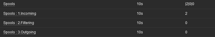

    i have a template that monitor my mail Q.​
    My values appear like this
Name:	Capture d'écran 2023-09-01 134642.png
    values are then separated according to the spools. (incoming, filtering, outgoing)
    I have triggers that activate when the number of mails in one of the Q exceeds 9.
    But I would like to avoid false positives and say that the trigger only activates if the value is greater than 9 for 5 minutes​
    I tried with different trigger but it doesn't work as intended
    For example with this trigger "count(/<template>,300)>=3" the trigger fired directly while my data is at 2 and only after 30 seconds.

    • JackoAC
      JackoAC commented
      Hello, thank for the your answer.
      i tried with the documentation you just send and it work, i just needed to change the format of data (text to number) so i could have the min function.
