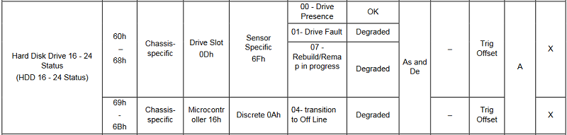

I have been trying to get discrete sensors working with zabbix to no avail. The Zabbix documentation says I should be able to do it.
I would like to monitor the power state of the machine or the hard drive status for HD failures.
Here is the output from ipmitool
Pwr Unit Status | 0x00 | ok
HDD 0 Status | 0x00 | ok
I added the sensor the same way I do voltage and temperature but I end up with "sensor or control Pwr Unit Status@[]:623 does not exist"
Has anyone successfully been able to monitor discrete sensors over IPMI?
Any help is greatly appreciated,
Thanks.
BTW I am on Zabbix 3
