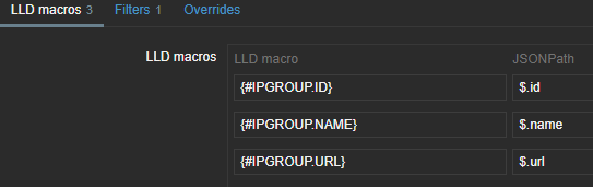

    The discovery rule use the following macros:
    The Json has multiple items and some have the "ARM *" in the name.

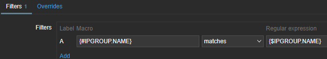

    I added a filter with the following macro:
    {$IPGROUP.NAME} = ARM
    The issue is that, when the discovery item runs, it only finds the first occurrence, therefore, only one item is created.
    Any thoughts on that?​

    Found the issue.
    The JSON data had the characters "ARM" with different case.
    I had to use [Aa] in the regular expression.
