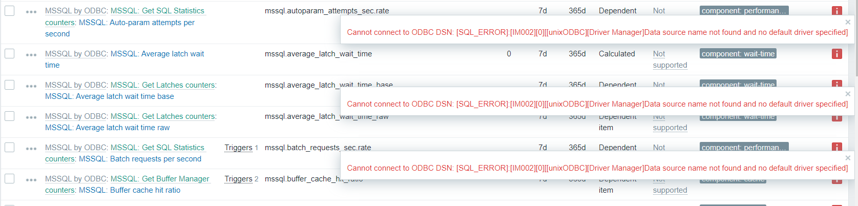

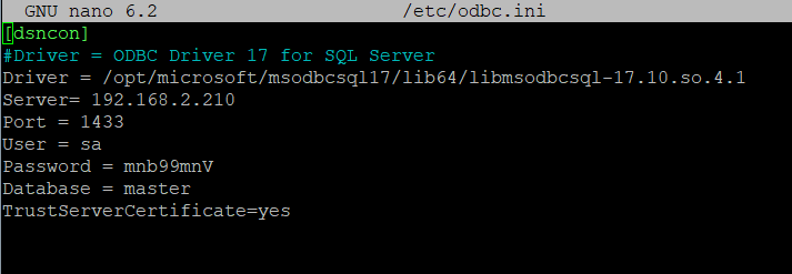

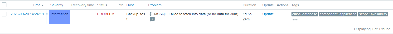

    Hello I get this problem when host try connect with MSSQL Database
    Here is some screenshots with my settings.

    For MSSQL username and password cannot be stored in odbc.ini and will be passed as arguments when using dsn name from zabbix frontend.
    Also Microsoft Sql server dont use directive "port="
    It should be after comma like this:
    Server = ipaddress,1433
    Also you need:
    Encrypt = yes

        Also, delete driver path from odbc.ini
        Driver above it is correct (commented out) and its name is referencing to odbcinst.ini
        Example
        odbc.ini:
        [MSSQLServer]
        Driver = this is my driver
        and odbcinst.ini:
        [this is my driver]
        Driver = /opt..<path to driver>
        On top of it check permissions is zabbix can execute odbc commands on the driver.
        And make sure your have StartODBCPollers​ at least set to 1 in for zabbix (or ZBX_STARTODBCPOLLERS=1 if in docker as environment vars). Its disabled by default​

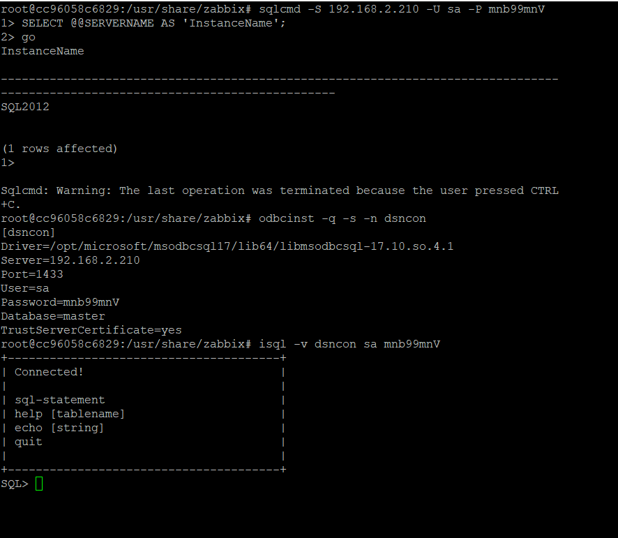

            • PiotrJ
              • May 2023
              • 26
              Ok I set 777 on file odbc.ini and yes odbc is installed inside marked container(on screenshot) in docker. And still without changes..

                ok i checked my test env this is how my odbc.ini looks like
                [DSN]
                Driver = ODBC Driver 18 for SQL Server
                DSN = DSN
                Server = TCP:<ip_address>, 1433
                Port = 1433
                TrustServerCertificate = yes
                Encrypt = false
                odbcinst.ini:
                [ODBC Driver 18 for SQL Server]
                Description=Microsoft ODBC Driver 18 for SQL Server
                Driver=/opt/microsoft/msodbcsql18/lib64/libmsodbcsql-18.1.so.1.1
                UsageCount=999
                regarding permissions check this file path (change to yours) not odbc.ini file permission:
                also not sure if this is supposed to be installed on web container. I don't use it from zabbix server just from proxy. In proxy we have only 2x containers : main proxy and db. And I have installed it on main proxy "engine" but for the server .... I'm not sure.
                When using on frontend create new item "database monitor" fill usr/psw even manually
                and try simple select - does it work at all?
                Also check logs on SQL itself to see if it "trying" at least to connect - if it reaching but failed login - then user permission. If there is nothing .. then to be honest i don't know.

                  When I look in item default created by mssql template i see this error
                  • PeterZielony
                    • Nov 2022
                    • 146
                    that means it cannot find DSN entry. or driver attached to it. so maybe it has to be installed on docker where zabbix is not web container. but I never did on server - I always used proxy to query SQL
