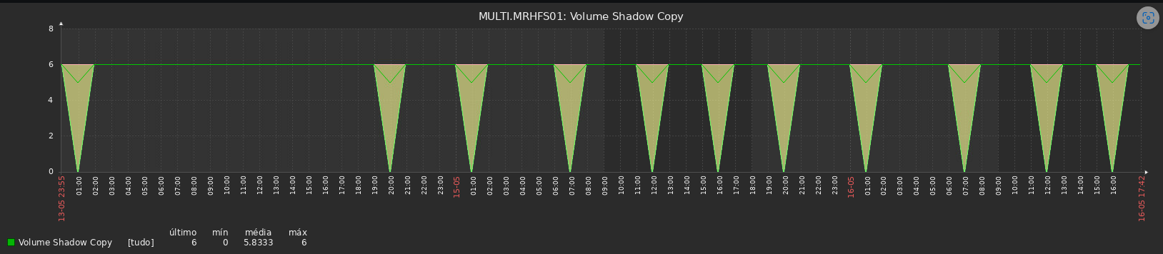

    I remember being able to gather somewhat precise metrics back in May, but it deregulated and I was never able to get similar results again with this. The only thing wrong with the metrics at the time is that it was detecting an activation of the service at 01:00, which was not included in the schedule, but otherwise, all other schedules were precise, weekends included. As you can see on the graph below, you had the service state line continuously at state=6, with dips to state=0 on the times that the service started. If there were no "dips" for more than 24 hours in a row, the trigger would go off indicating that a scheduled Shadow Copy job did not run.

Name:	MayMRHFS01 Metrics.png
    Does anyone know how I can faithfully monitor the service status during the shceduled times without the state being perpetually stuck at 255 or 6? I've tried to the best of my capabilities to revert the configurations i've made to the ones in May, but despite being able to revert the trigger configuration, the graphs did not respond the same way as it did back then.
