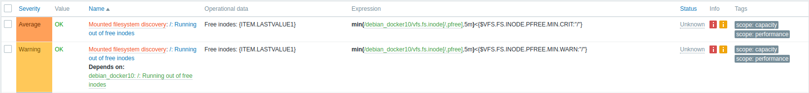

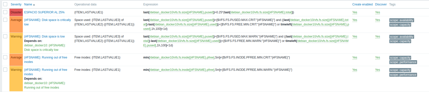

    i created a trigger prototype but isn´t on the triggers area.
    How can i add that prototype trigger in the triggers that are currently working?
    Your trigger is created, but it has somekind of issue . Click on that red "!", find out what's the issue, and fix it.
    It also has yellow "!", which would indicate, that this item/trigger is not discovered any more and will be removed soon...​
    • dimir
      Zabbix developer
      • Apr 2011
      • 1080
      Prototypes aren't under "Host -> Triggers", they are under "Host -> Discovery -> [Discovery rule] -> Trigger prototypes".
