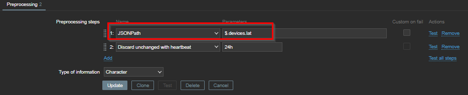

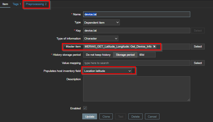

      This is the Master Item that get the Json information
      This is a Depend Item that filter the Json and populate the correspondign Inventory Field​
