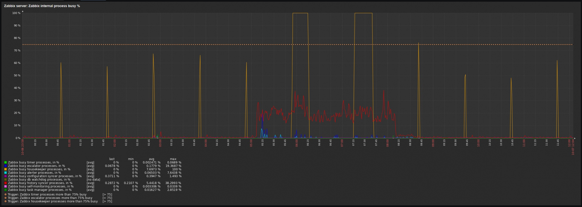

    In the process graphics is visible that the history syncer percentage (red line) is highly increasing at 5am. Thereby the housekeeping process also increases his percentage when started.

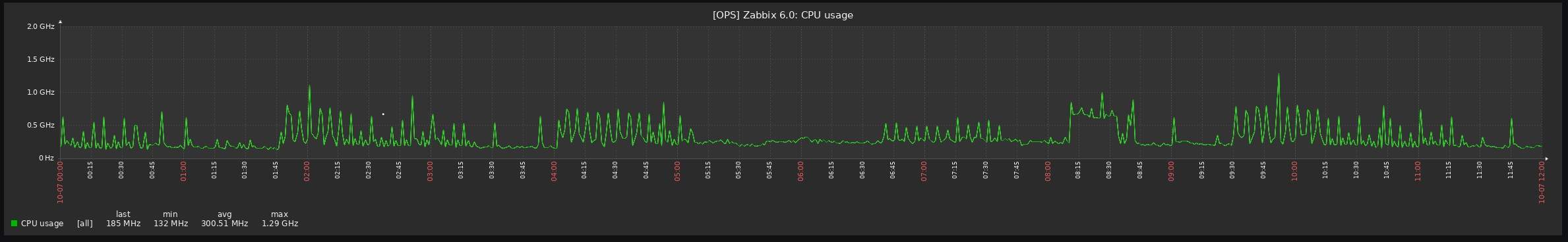

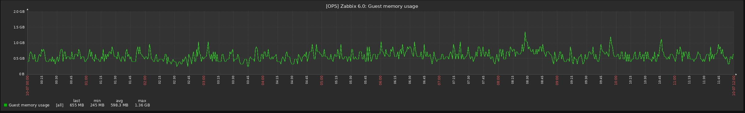

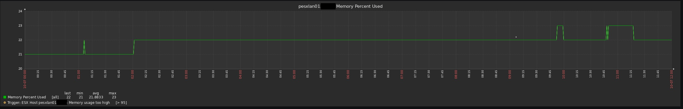

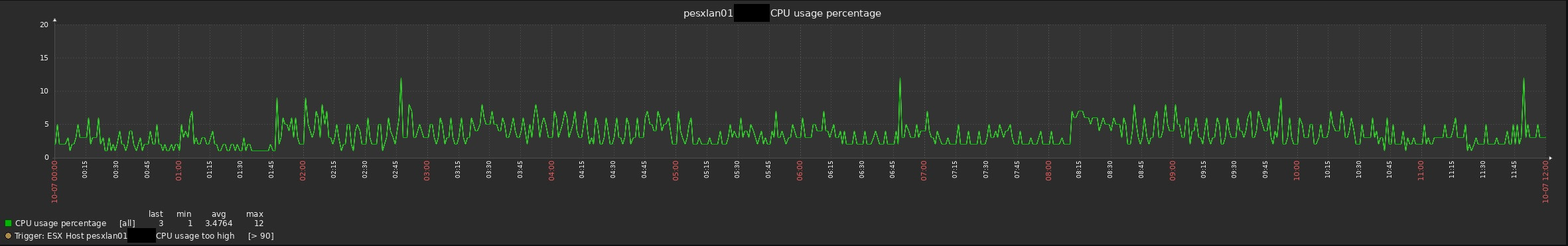

          Screenshots attached:
          2x ESXi performance
          2x VM performance
          1x Zabbix processes

            Maybe just a wild guess, but what else is going on in your env at that time? Seems that also escalator and alerter processes go up in usage at that time. Any alert storm at that time as other hosts in your env do strange things?

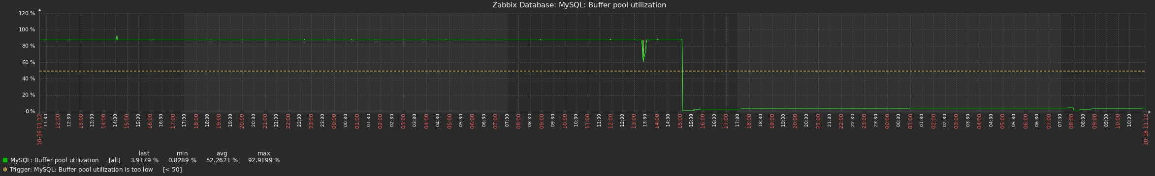

              As in the screenshot "231018_Database_BufferUsage.jpg" visible, the buffer utilization dropped by 80%.

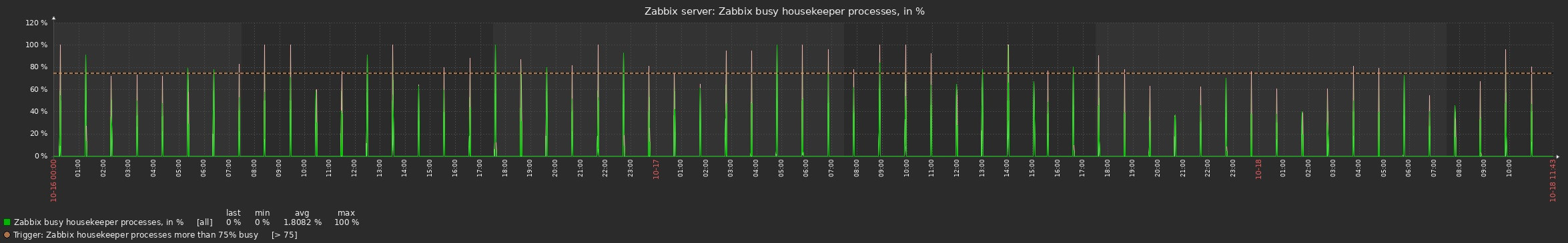

              Also the screenshot "231018_Zabbix_HousekeepingProcess.jpg" shows a slightly lower housekeeping process usage (changes were at 17th October at like 3pm).
              I have some positive vibes that this could help and hopefully sort our problemes upcoming saturday.
