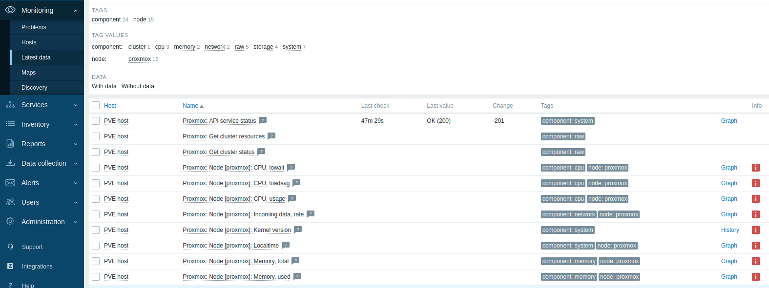

      So I still get this when checking Latest data under Monitoring
      Click image for larger version  Name:	image.png Views:	2 Size:	36.0 KB ID:	471265​

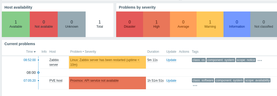

      and this

        Trigger showing API service available. It may be permission issue. Please check with above given link.

              Now I was able to add the required permissions to the zabbix account on PVE. One step closer I guess, but still the same issue. I did restart the zabbix-agent service on PVE and rebooted the Zabbix server. I still get this

                    5. Selecting Latest data show this
                    So here we are. I cannot think of anything that I may have missed. PVE version is 8.06 and Zabbix 6.2 (agent and server appliance)
                    Agent logfile on PVE does not indicate any errors.
                    Server logfile on the Zabbix server has this error message. Unfortunately is doesnt tell which hostname is missing/failing. It would have been quite useful ...

                        I'm not sure what I did, except adding a macro PVE.HOST.NAME, but it seems to be working now. I see a lot of stuff in "Latest data" now, but most of the data is empty. So some progress at least ...
                    • andersostling56
                      • Sep 2023
                      • 7
                      This looks better. Next is to actually have data pulled from the agent
