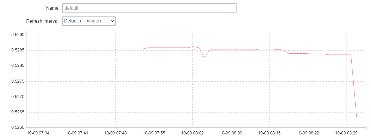

        • Killingot
          • Oct 2023
          Hello again,
          The graph shows me some very strange values:
ID:	471782​Right now, in this partition, there are about 15GB left. I need to get the value in GB. Any suggestions?
          • adrian_c
            • Nov 2018
            • 12
            pfree will give percentage free, if you want actual free space, then just use free
            for the key vfs.fs.size[fs,mode], possible values for mode are:
            total (default)
            free
            used
            pfree (free, percentage)
            pused (used, percentage)
            So in your case for the total free space on drive E: use
            vfs.fs.size[E:,free]
            All this can be found in the documentation: https://www.zabbix.com/documentation....sizefsmode​
            • Killingot
              • Oct 2023
              Thank you very much adrian
