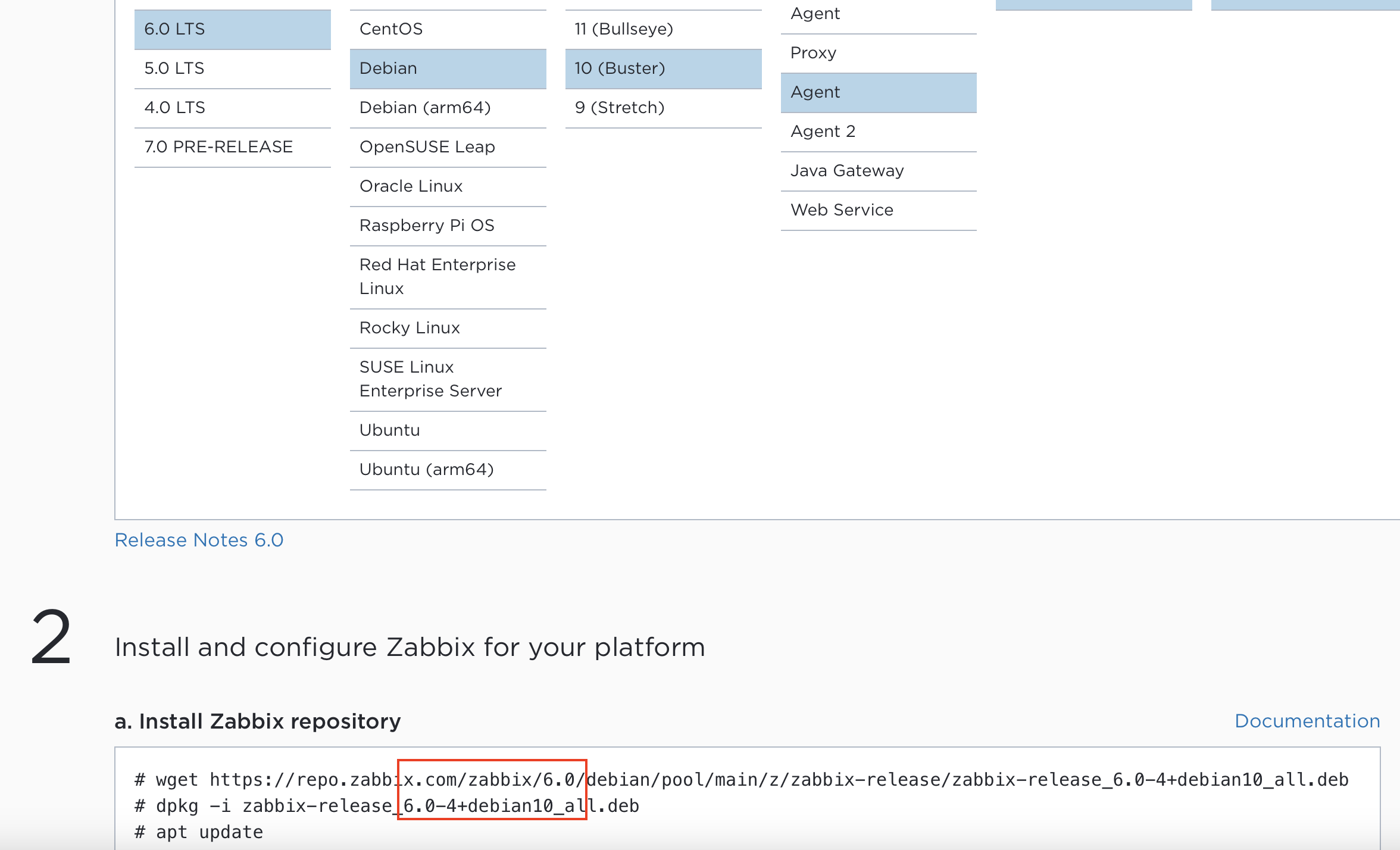

      Or install the repository package for 6.0 called zabbix-release and then just apt install zabbix-server-<database> and zabbix-agent:

        dimir you are right, the problem here is that the repo is pointing to the "https://repo.zabbix.com/zabbix/4.0/debian/pool/main/z/zabbix-release/zabbix-release_4.0-4+debian11_all.deb"

        • dimir
          Zabbix developer
          • Apr 2011
          • 1080
          Looks good to me:
          • aby
            • Oct 2023
            dimir, yes, you are right. Sorry, I didn't understand your intention.
