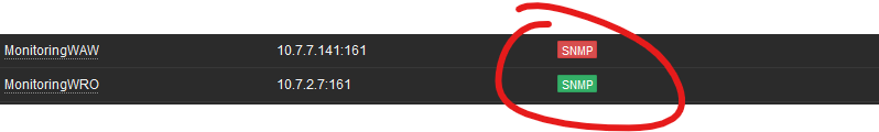

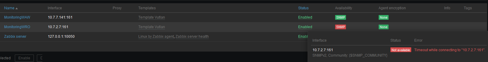

    I'm just beginning my journey with Zabbix. I've watched about 5 hours of YouTube tutorials on how to use it, but I'm still unsure how to receive email notifications for a dead SNMP service on a monitored host.
    As an example, let's say my host with the IP 10.7.7.141 changes its status from "green" to "red". I'm only able to see this "red" status when I log in to the system and view it firsthand. How can I receive an email notification about it?

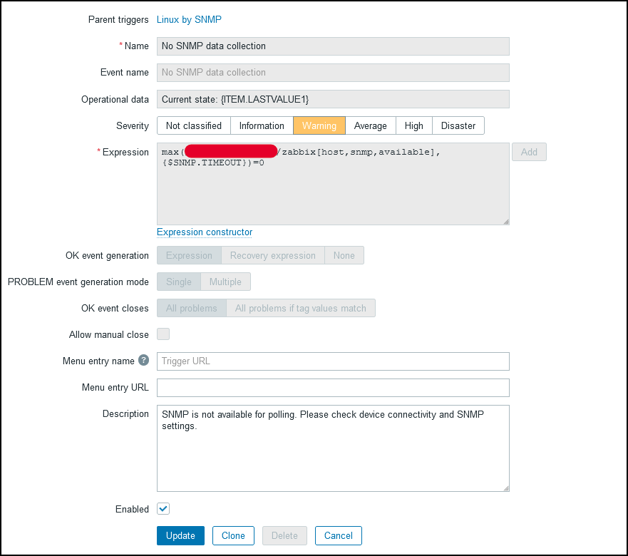

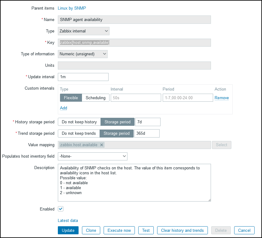

    You can create the item for SNMP agent availability as per below SS.
    After item create you need to configure the trigger.
