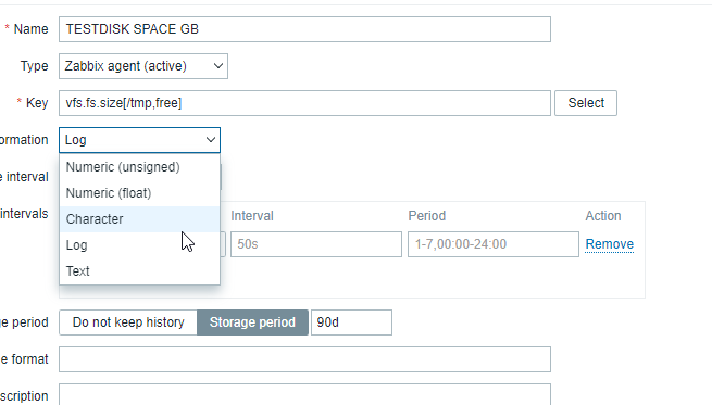

    Dear All,
    Im trying to set up item/trigger and alert trigger, that if a disk (like C or D drive) is below 5GB (or in KB = 5368709120)
    Now in the table, it will show me only vsf.fs.size.

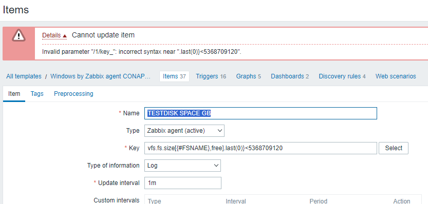

    When i try to moderate it (or the KEY item) it wont let me add the numbers
    For example:
    {Template OS Windows:vfs.fs.size[{#FSNAME},free].last(0)}<5368709120​
    Every time i wanna save the item/trigger, its saying cant add key: (see screenshot error zabbix_item_adjustment.error)

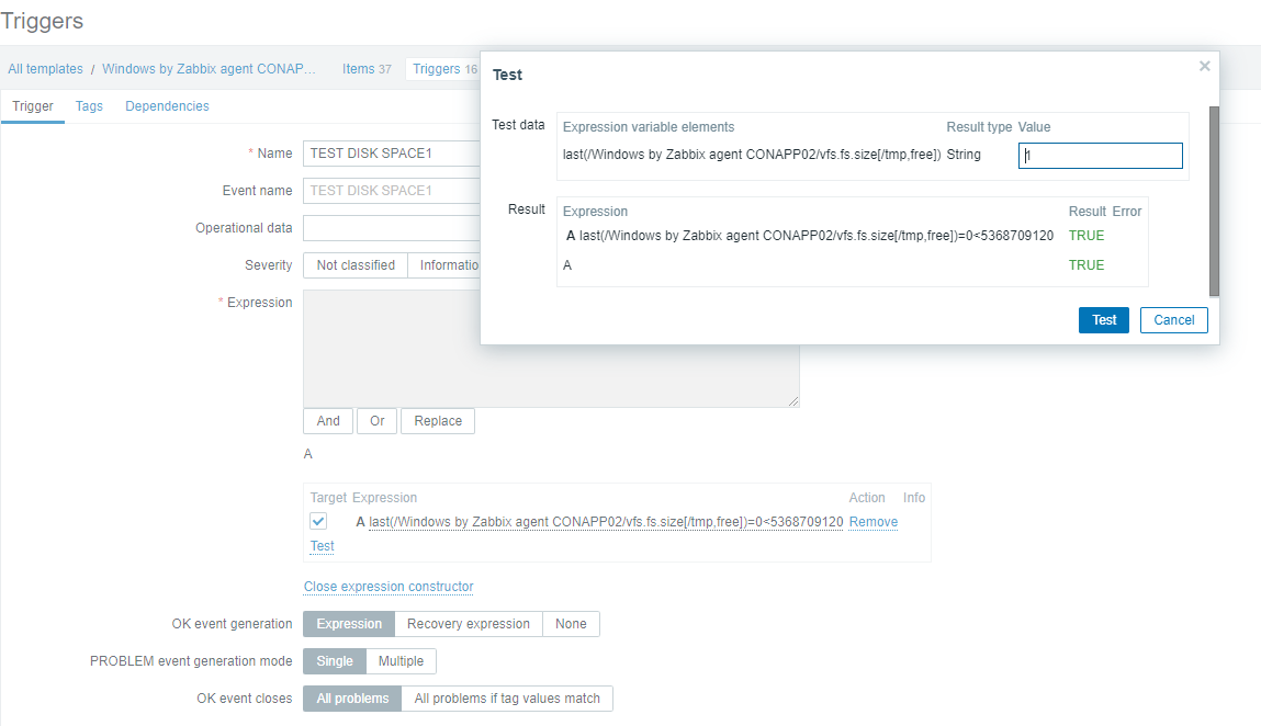

    But now comes the strange thing.
    When i go to trigger and then to this item and select Constructor Exporession and test it with vaulue 1, i get true, but if i select 0 i get false.
    Click image for larger version  Name:	Zabbix_item_adjustment_error.png Views:	11 Size:	30.4 KB ID:	472474

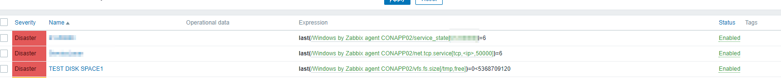

    you cannot add trigger expression into item config...all that last(... )< belongs to trigger config... different tab.. and FS size probably is not a log type, but a integer.
    and what is this "=0<5368709120" contraption on those attached pics? its either "=0" or "<5368709120" but not both...

      I just checked, but i dont see the Type of Information 'Log' can be changed to Integger

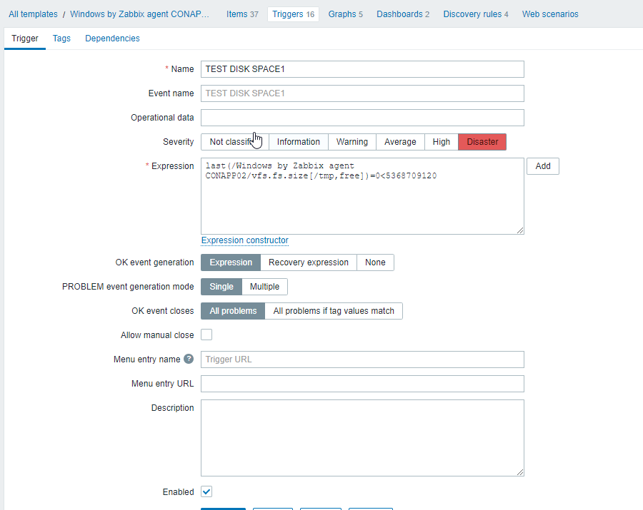

      Also, =0<5368709120 is a trigger i want to go off when the disk space is lower then 5GB (and 5GB in KB's = 5368709120)

        ok .. then "Numeric(unsigned)"
        And no, "=0<5368709120" is not a suitable trigger function... your trigger prototype most probably should be something like "last(/Windows by Zabbix agent CONAP.../vfs.fs.size["C:",free])<5368709120"

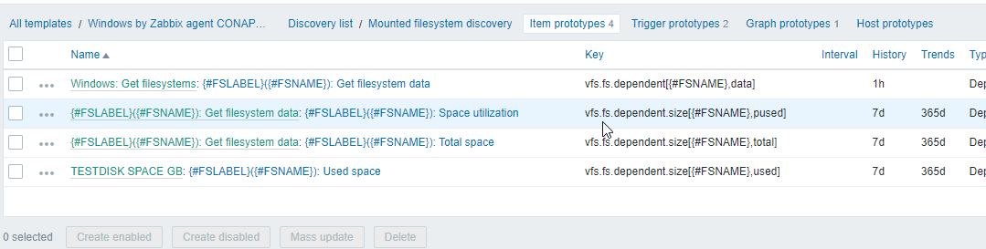

        EDIT: oh.. I just noticed.. why you are trying to use LLD macros in ordinary items... ? Macros like {#FSNAME} belong to discovery and item/trigger prototypes, not to "ordinary" items...

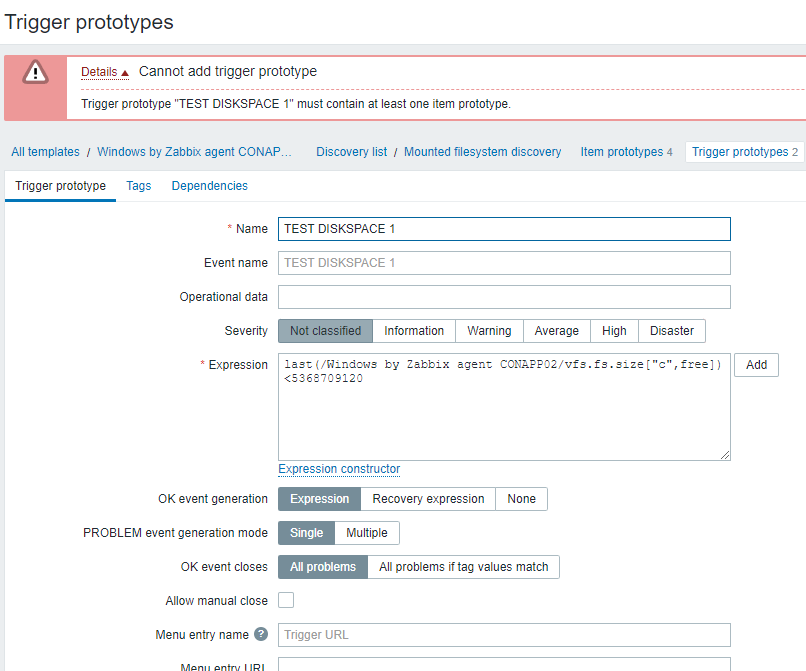

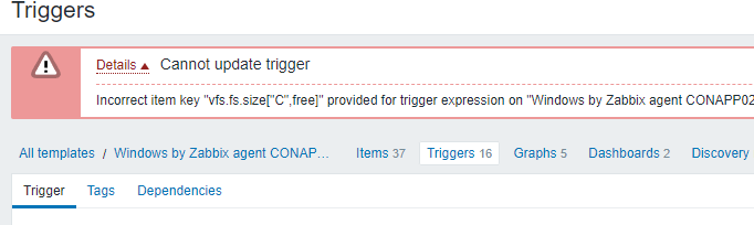

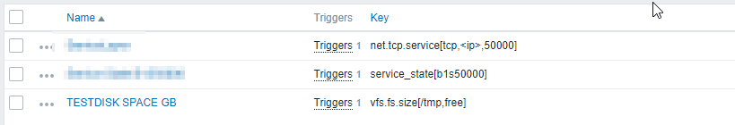

          Make item, and try to change it to read the "last(/Windows by Zabbix agent CONAPP02/vfs.fs.size["c",free])<5368709120" (But dusnt work) without the <5368709120 i can add the item.
          Then i go to trigger, select the key last vfs.fs.size and that will allow to save it (vfs.fs.size["c",free]
          Then i tryed to make a Alert trigger that will let us know in teams that the disk is low.
          So what im a missing to make this work to show me how much GB theres left on a disk, and how to set up a correct trigger to get this working.
            This is just wrong...
            if you configure the item (and not a prototype in discovery), then you do not configure any thresholds there... Just as it does not allow you to save that item with all the "<5368709120" added.. your items config should only contain "vfs.fs.size["c",free]" as key... ( if adding a prototype then "vfs.fs.size[{#FSNAME},free]"
            Then you go to "triggers" and add one... with the expression "last(/Windows by Zabbix agent CONAPP02/vfs.fs.size["c",free])<5368709120" ...

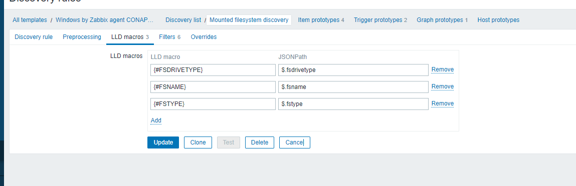

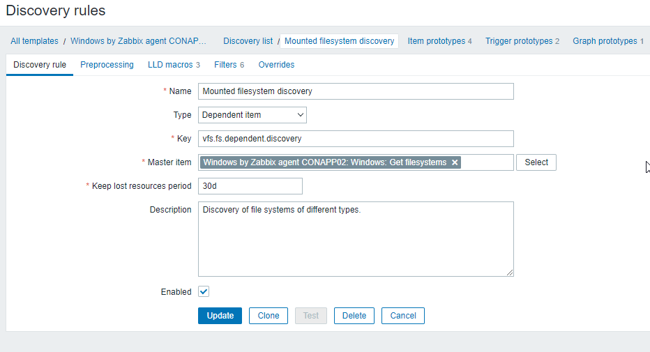

            You seem to have one discovery there already with all the items and triggers... Why you trying to add more?
            If all you want to add is a different threshold to your C drive trigger, you probably should look into template or host macros... There seems to be already a general macro, what applies to all discovered mountpoints... {$VFS.FS.FREE.MIN.CRIT} and it is set to 5G. If you look on trigger prototype, then you may notice, that it uses contexted macro "{$VFS.FS.FREE.MIN.CRIT:"{#FSNAME}"}". So... if you need different threshold to one drive, you should add a macro {$VFS.FS.FREE.MIN.CRIT:"C:"} (for example) with different value... and it will be used. If you add it to template, it will be used on all hosts where this template is installed, if you add this macro on host level, it applies only to that host.
