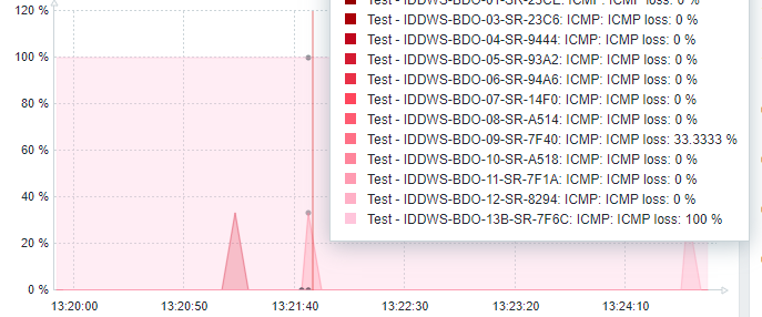

    Exclude icmppingloss under 80% from graph
    I want to ask, so that the graph only displays icmppingloss above 80% and ignores those below 80%, how do you do it??
    Thankyou

    Did you define the macro for minimum value?
    • ganyjar
      ganyjar commented
      Yes, I have changed the macro, for example to 80 or 90, but it has no effect on the graph, Do you know why that is?
  • vijayk
    • May 2023
    • 305
    In graph one value (33.3333%) also showing means graph is showing the value. Did you check the value history? Is is showing the ICMP loss?
    • ganyjar
      ganyjar commented
      Yes, the graph shows according to history, but can the graph only display values above 80% and ignore it if the ICMP ping loss is below 80%?
    • ganyjar
      ganyjar commented
      Because the device I ping is going through the VPN, so I want to tolerate if the ping loss is below 80% and I want to display anything above 80% in the graph.
  • vijayk
    • May 2023
    • 305
    Need a deep dive in the issue. Did you do manual ping to check the loss?
