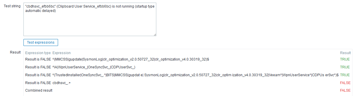

    I try to use the regular expression in general -> regular expression in the category "windows service discovery" like this:
    If I test, it works:
    But in the problem tab, it still there, even if I wait 1 hour, suppress, it come back:
