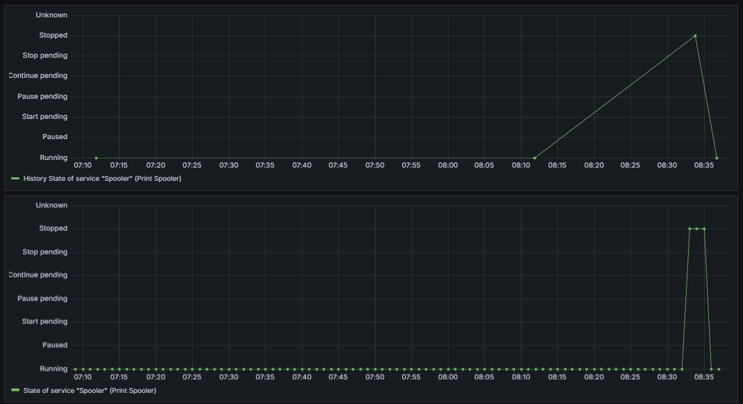

                I tried something like this (still evaluating)

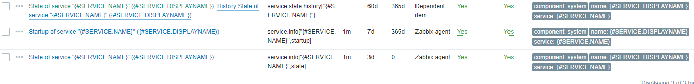

                Click image for larger version  Name:	image.png Views:	0 Size:	45.6 KB ID:	511878Created a dependent item to the standard "State of service" with the "Discard..." enabled, and adjusted the History & Trends-value.
                I then mapped the trigger to the main State-of-server-check.
                Click image for larger version  Name:	image.png Views:	0 Size:	36.6 KB ID:	511879
                It seemes to work as planned, but haven't implemented it yet in Prod.
                Screenshot from Grafana of the values of each check, where the trigger was fired on the 3rd failed check.
