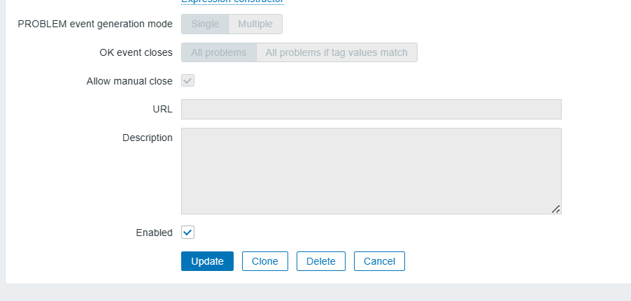

    ​Because your trigger doesn't have the option to allow manual closure of the issue, you can't manually close the issue that arisesClick image for larger version
