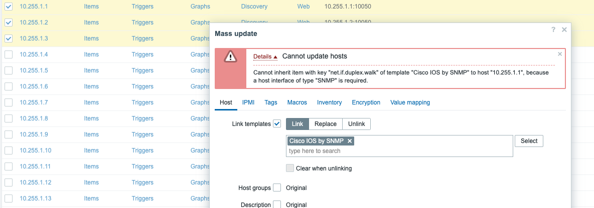

    Hi
    I want to avoid OID, I spent the whole day searching for away to process discovery by SNMP template, is there any option for this?
  • Moawia
    • Nov 2023
    I discovered the devices with ICMP, and now I am trying to link them to SNMP template to get the data, but I am getting this error, is there any option to add SNMP interface to the host?
    I know I can do it manually, but I have over 600 device!
