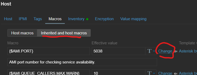

    To use any template with macro on multiple hosts, never define the macros in the template.
    Define macros on the host.​
    If you don't want to copy the macros from the template, you click on "Inherited and host macros" and click on change:

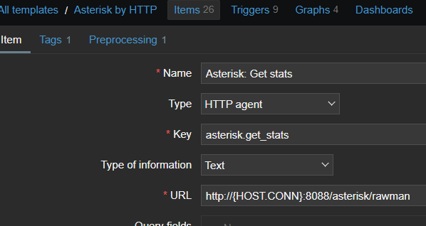

        In the case of this "Asterisk by HTTP" template, try the following:
        From:
        Items --> Asterisk: Get stats --> URL: {$AMI.URL}
        To:
        Items --> Asterisk: Get stats --> URL: http://{HOST.CONN}:8088/asterisk/rawman​

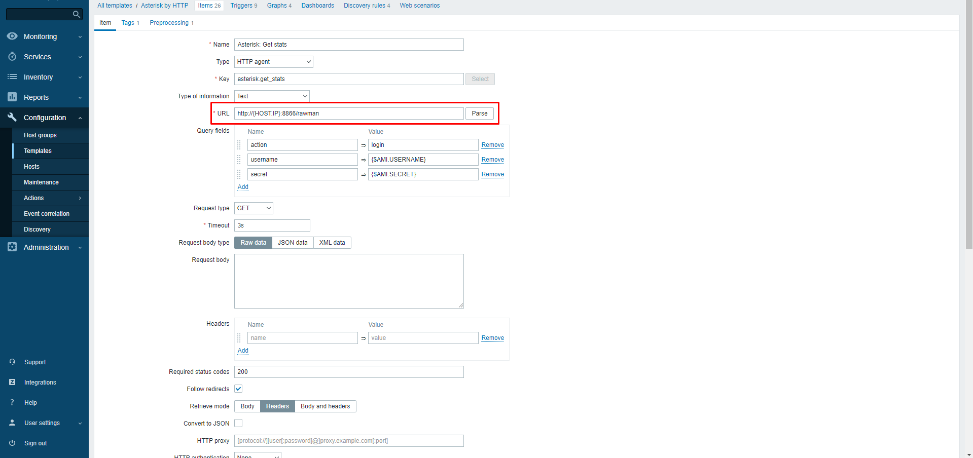

          Ok so first,
          I found out that if you set the URL this way in the the HTTP Agent
          http://{HOST.IP}:8866/rawman
          it's reading the host IP properly.
          It's also reading the host IP properly in the way you mentioned - http://{HOST.CONN}:8866/rawman.

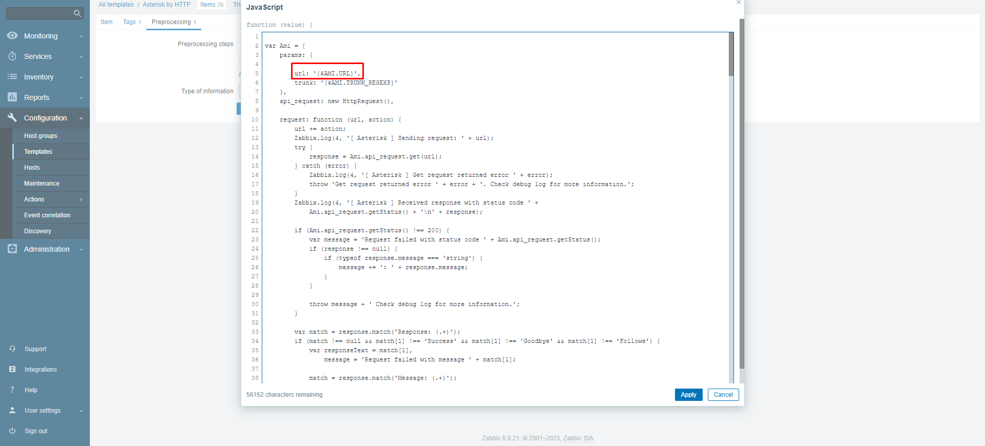

          However, I see that the issue now is with the preprocessing JavaScript -
          need to set the url to be dynamically the host IP,
          but it turns out that it's not possible to use built-in Macros in preprocessing scripts.
          The url is set this way by default in the preprocessing script:
          url: '{$AMI.URL}'
          So need to find a way to set the url like this:
          url: 'http://{HOST.IP}:8866/rawman' - which isn't working there unfortunately..
