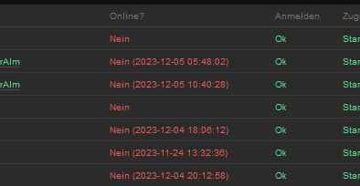

      Good question,
      in Zabbix under Administration->Users the “ONLINE?” Status is displayed, and this is exactly the status I would have liked to log.​

        • 4997
        That comes from "sessions" table. I suspect, that this is updated together with user activity and when last activity is far enough, it is declared as "not online"... But I am truly not sure about how that thing exactly works...
