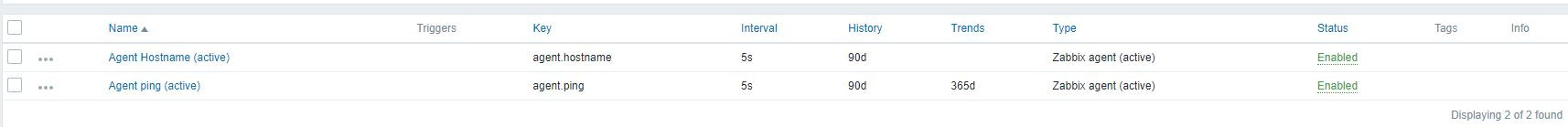

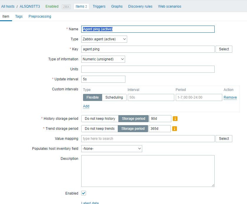

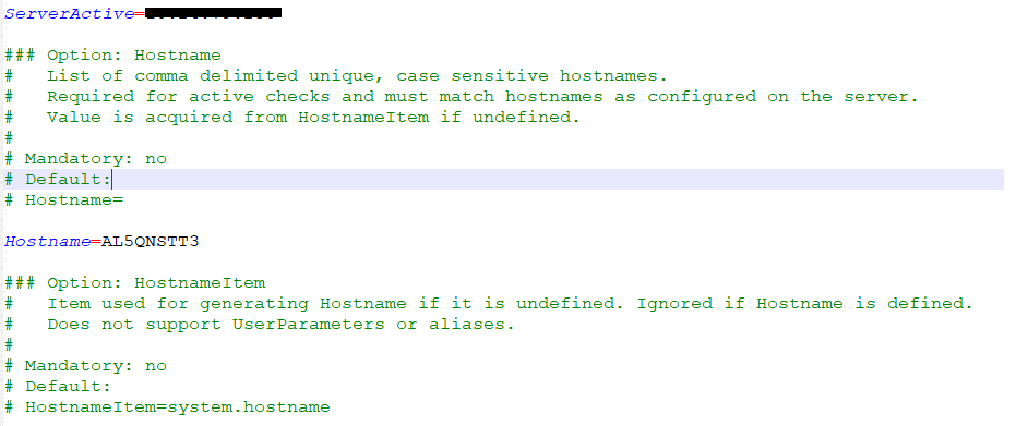

      Hi Solution, Thank you for the reply.
      I have already tried what you described. May be my configuration was off? refer to the screenshots I have attached. AL5QNSTT3 is the test host (win 10) I am using. I already tried this with the FQDN but no luck.​

        Hi Antony,
        The items you showed are for Active Mode.
        1) In Active mode, the Agent installed on the Hosts consults the Zabbix Server and receives the list of what to monitor on the host.
        2) IP or FQDN defined in Interfaces are NOT used.

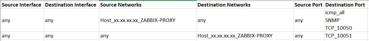

          Thank you for your reply, Solution.
          Please refer to the screenshots I have attached. I have already configured the Zabbix Agent config file to point the “ServerActive=Zabbix server” and “Hostname=AL5QNSTT3”. I tried changing the host name to FQDN as will with no luck. The ports 10051and 10050 is open from my local to Zabbizx server. Unfortunately, I don’t have access to the Zabbix Linux box to see if it can resolve to my test pec. I have already asked the cyber guys to verify that and waiting for their feedback. I do have the following firewall (attached) rule set in the firewall for Zabbix.

            I think after so many tests everything seems confusing.
            In the images above there is no Host Latest Data screen, so start over.
            How is data collection going now?

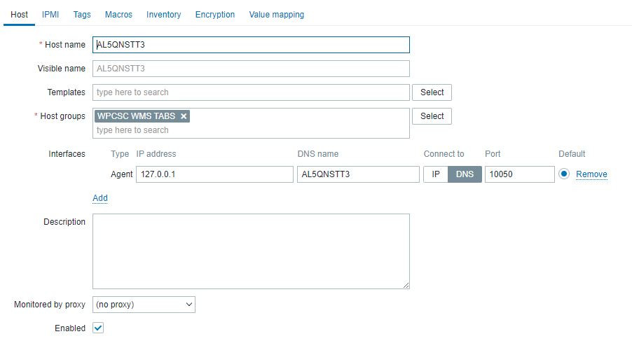

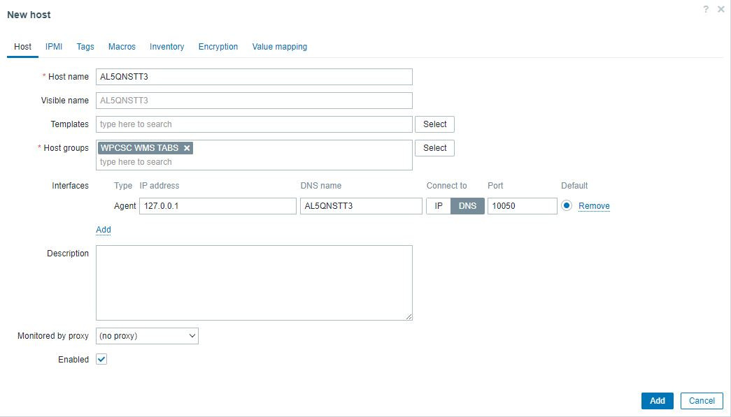

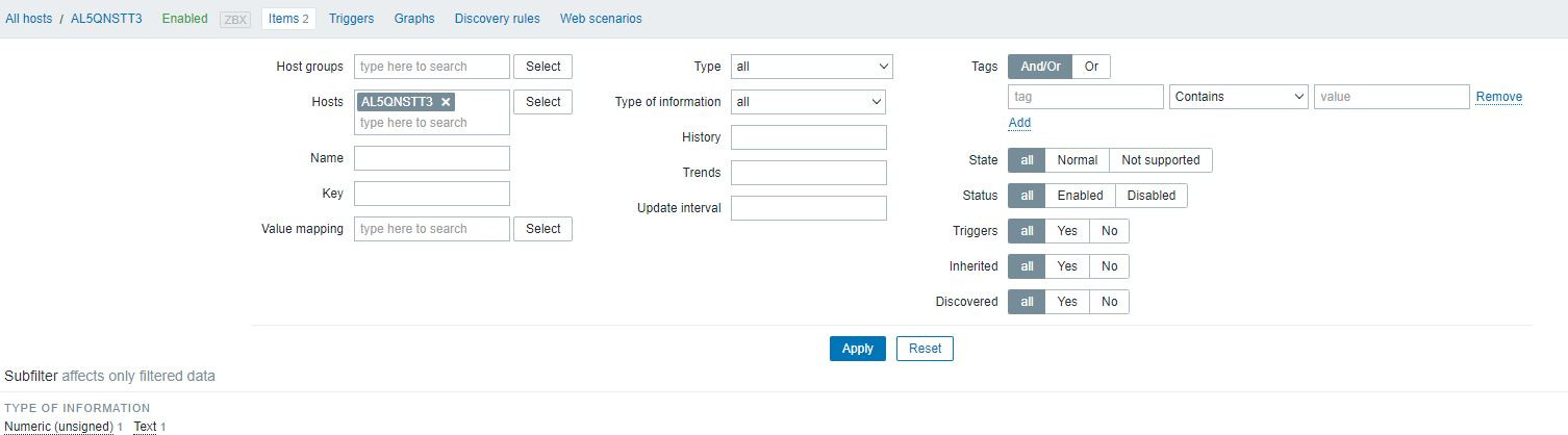

              Hi Solution, Like you mentioned I have started over (deleted all previous entries from Zabbix)
              Added host
              Zabbix Gui > configuration > host
              Hostname: AL5QNSTT3
              Template: wouldn’t let me add the name Windows by Zabbix agent so left blank
              Interface: DNS (AL5QNSTT3:10050)

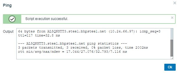

              Before adding any items, I went in to Monitoring > Hosts > AL5QNSTT3 > right click > ping
              --- AL5QNSTT3.xxxx.xxxxxx.net ping statistics ---
              3 packets transmitted, 3 received, 0% packet loss, time 2003ms
              rtt min/avg/max/mdev = 17.859/19.458/21.404/1.467 ms

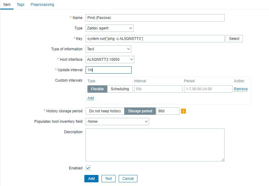

              Then went in to Zabbix Gui > configuration > host > AL5QNSTT3 > Add item
              Name: Ping (passive)
              Type: Zabbix agent
              Key: system.run["ping -c AL5QNSTT3"]
              Type of information: Text
              Host interface: AL5QNSTT3:10050
              Update interval: 1m > Save

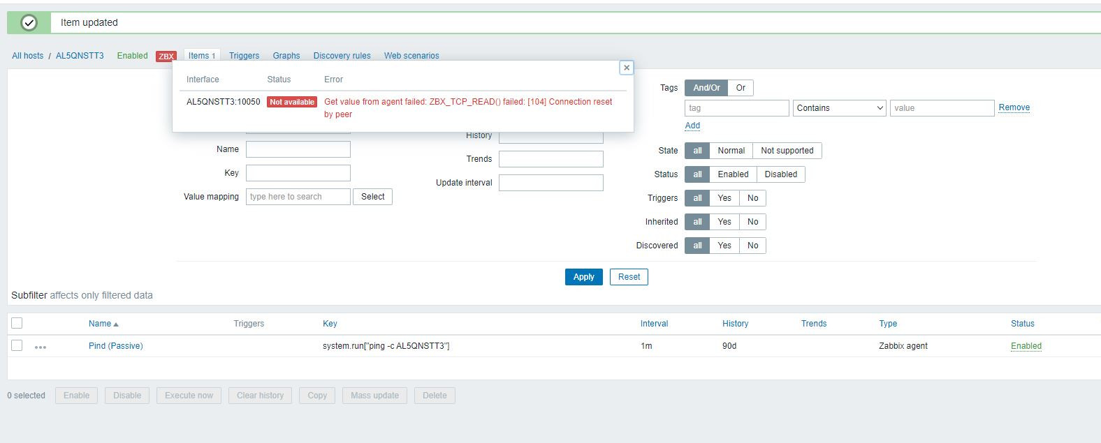

              Zabbix availability is still Red with the error
              Get value from agent failed: ZBX_TCP_READ() failed: [104] Connection reset by peer
              There’s no log file under C:\Program Files\Zabbix Agent\zabbix_agentd.d

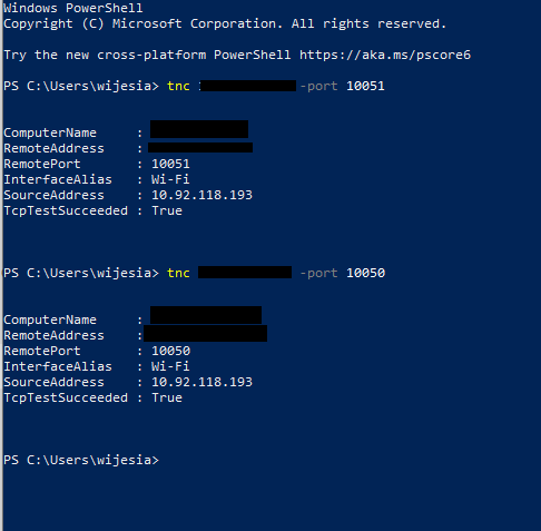

              At the same time I restart the Zabbix Agent service and ran a netstat netstat -abn. Oddly enough it is listening to port 49664 (screen shot attached)

                1) From your test on the interface, ping by dnsname is working.
                And since you didn't send the Host's "Latest Data" screen, if you check the created item it is also receiving data, correct?
                2) do the test in Active Mode by associating the template "Windows by Zabbix agent Active" or "Zabbix Agent Active" and check the Host data collection in Latest data.
                3) We can see in your prints that the Agent is listening on port 10050
                4) the "Zabbix availability is still Red with the error" the message "indicates that it is not possible to communicate with the Agent on port 10050.
                - Disable the Host Firewall temporarily;
                - Change Interface Agent from DNS to IP and define the Host IP;
                - Associate the "Zabbix Agent" Template with the Host;
                - Does Zabbix server have a firewall with outbound traffic rules? allow outgoing traffic to hosts and port 10050/TCP
                Observations:
                - Zabbix availability only turns green if you use Passive Mode (unknown appears in active mode)
