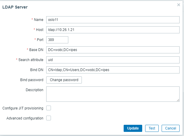

    I try to configure LDAP authentication in Zabbix
    I did configure it this way
    but when I test it with the test button, it tells me "Cannot bind to LDAP server"
    I used samaccountname because the ldap server is AD
    ​When I try
    ldapsearch -b "dc=wobi,dc=ipes" -H ldap://10.26.1.21 -D "CN=ldap,CN=Users,DC=wobi,DC=ipes" -W
    on the console on the same Red Hat Enterprise Linux 8.9 where Zabbiy is installed, then it works
    # numResponses: 1004
    Can anyone please tell me what could be wrong in my configuration?

    in the host section, you can try ldap://10.26.1.21:389
