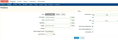

    Hi okelet,
    Yes. On Zabbix 3.2orc1 a new option exist (Monitoring / Problems) from where you the ability to filter you selection with all the filter values you mention.
    Attached you will find a screen shot of this option
    Costas

      Hi, thanks your response. Your screenshot is not very good, but I have seen this page in the documentation for version 3.2 - https://www.zabbix.com/documentation...oring/problems. Anyway, I don't see there any option to search by datetime range, just the option (that already exists in 3.0) "Age less than". Is there any other option not shown in the screenshots?

          [SOLVED] Search events by date and text
          Hi! Yes!!!!! I were going this morning to test Zabbix 3.2RC, but Zabbix 3.2 official has been released!!! This is a better screenshot from Zabbix 3.2 showing what I wanted to do (notice I have to select "History" option):
