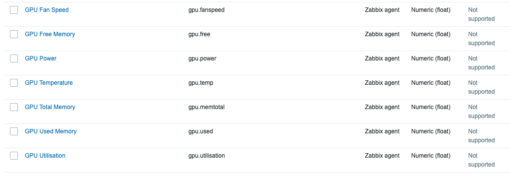

    Dear All,
    I have few machines with NVIDIA, wanted to get parameters of the NVIDIA GPU,
    We downloaded the template and imported to the zabbix server it from the url
    https://github.com/zabbix/community-templates/tree/main/Server_Hardware/Other/template_nvidia-smi_integration/6.0"
    Then for each host, we applied the NVIDIA template, but in the graph when selected, it shows the values as Not supported, as shown in the screen shot
Name:	Screen Shot 2023-12-12 at 1.31.55 PM.png
    Guidance requested for us to enable the GPU parameters

    THANKS, I was able to get the values now ,
    I had to create conf files in the plugins directory
