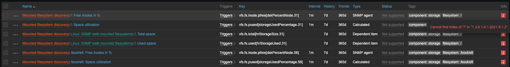

      Thanks for that, I had seen that in the items screen for the hosts but wasn't quite sure what it meant and now I know why.
      I can get CPU usage as well as total utilized space, but disk info among other thing just isn't there and the below screenshot is likely why:
Name:	Screenshot 2023-12-14 at 7.20.34 AM.png
      I've made some changes to the snmpd.conf file on the system that is being monitored [changed rocommunity public to rocommunity public default -V all and restarted the service], but either that change didn't work or something else is amiss.
      I'll keep at this but if there are any other pointers for anything else I might be missing, those would be appreciated!

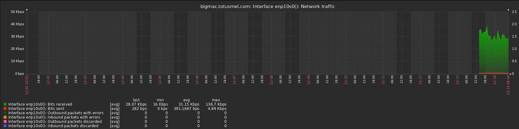

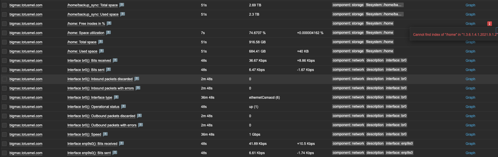

              I poked around a little further under Monitoring --> Latest data and selected the system that I have SNMP monitoring enabled on and I'm seeing values there:
              Click image for larger version  Name:	Screenshot 2023-12-14 at 8.28.25 AM.png Views:	0 Size:	192.5 KB ID:	475872

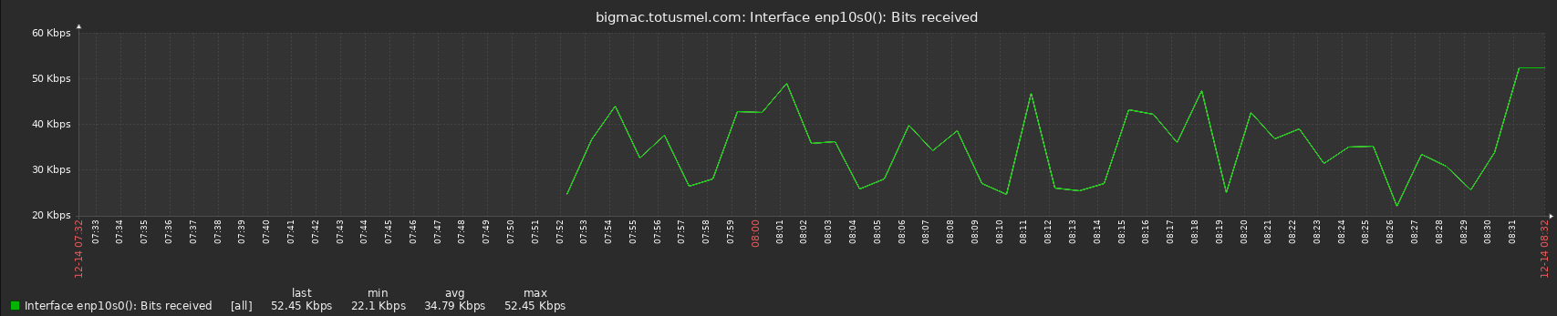

              If I click on the Graph from the above, I do get a nice looking graph [except for the red exclamation items for obvious reasons]. The below is one of the network interfaces on the system:
              Click image for larger version  Name:	Screenshot 2023-12-14 at 8.32.36 AM.png Views:	0 Size:	46.1 KB ID:	475873

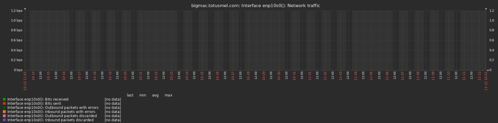

              It's just when I go to Monitoring --> Hosts --> Select the Graphs for a system is when I don't get any results:
              Click image for larger version  Name:	Screenshot 2023-12-14 at 8.38.16 AM.png Views:	0 Size:	43.7 KB ID:	475874
              ...I think I found the problem. I just noticed that the date range was for something in November. I updated it to something more recent and I'm getting results now:
              Click image for larger version  Name:	Screenshot 2023-12-14 at 8.40.07 AM.png Views:	1 Size:	54.2 KB ID:	475877
              Big DOH! on my part.
              I'm going to continue tinkering with this and I'll post back if I have any further questions.
