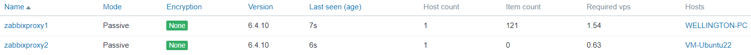

            For each service that will be accessible externally, you need to open a unique and exclusive port.
            then configure each of them on a different port and do port forwarding.
            Proxy example:
            Or you can use in ActiveMode or VPN as already suggested by PeterZielony​ e Hamardaban​
            Wellington​
