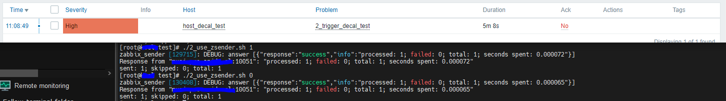

      Hi Hamardaban, thanks for your answer​, Im testing you first option: .count(2m,1)}>0
      The problem is that if the 0 (to recover the trigger) arrives before that 2 minutes, the problem never closes, only after those 2 minutes I can close the problem
      in the screenshot below, I send a 0 to zabbix, seconds after sending a 1.
      Click image for larger version  Name:	image.png Views:	1 Size:	38.2 KB ID:	476737​​
      So Im looking for something like this: if a 0 arrives before the 2 minutes, dont recover the problem until those 2 minutes has passed.
