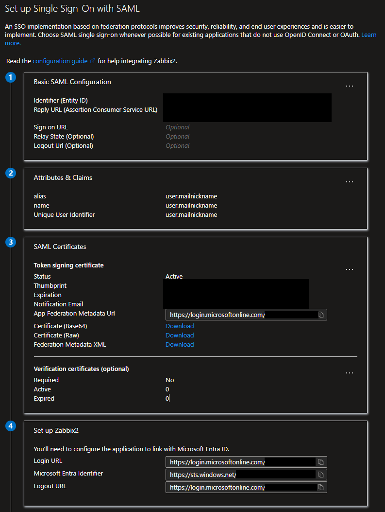

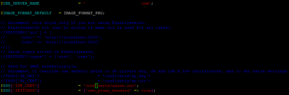

    Yes, you need to enable some SSO settings in /etc/zabbix/web/zabbix.conf.php. See attached. You get the certificate from your enterprise app. Download the B64 (base 64) version. Linux doesn't do well with the binary version. See attached.
