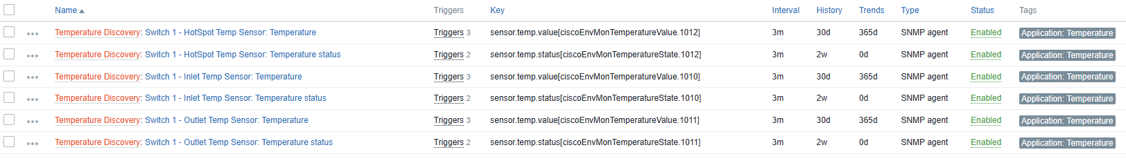

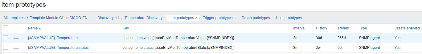

          • Glukas
            • Nov 2021
            • 17
            Items:
            Triggers:
            I can easily add {$TEMP_CRIT:"Inlet"}, {$TEMP_CRIT:"Outlet"} and {$TEMP_CRIT:"Hotspot"}
            But I don't get how do I connect their values once they discovered?
            Many thanks in advance!​​

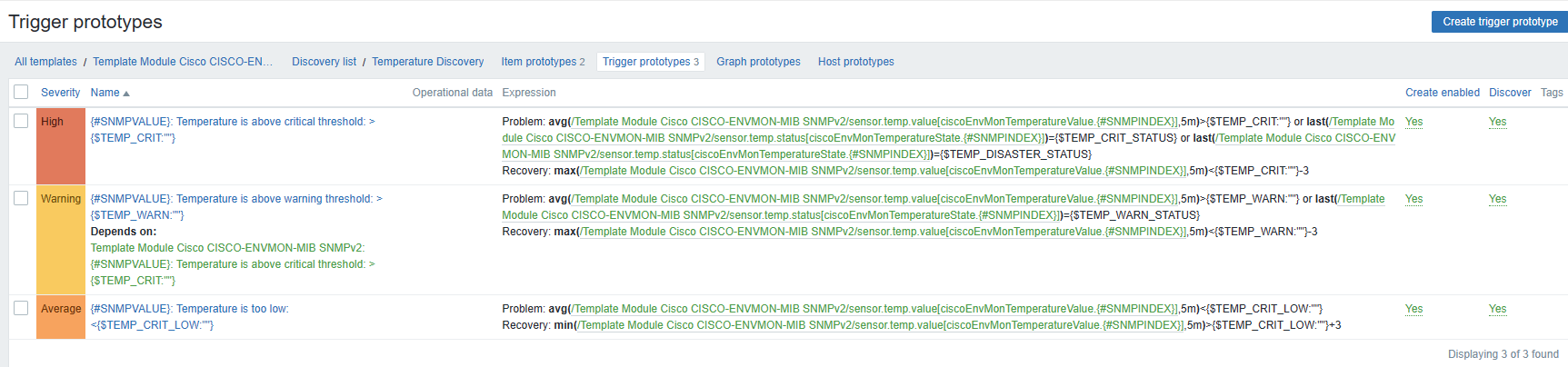

            • ISiroshtan
              • Nov 2019
              • 324
              Huh, that is lame. It seems to not be assigning context for threshold. If you see in trigger prototype you have {$TEMP_CRIT_:""}, so it does not try to assign different contexts for different sensors.

                • ISiroshtan
                  • Nov 2019
                  • 324
                  Aha, ok, we should be able to make it work. Probably...
                  Firstly: I would advise to create a copy of existing template and do all changes on copy. Then assign Copy to one host and verify if all works as you want. This way you have untouched original template and another one where you testing changes.
                  So what you could try to do is modify the trigger prototype, from:
                  {Template Module Cisco CISCO-ENVMON-MIB SNMP:sensor.temp.value[ciscoEnvMonTemperatureValue.{#SNMPINDEX}].avg(5m)}>{$TEMP_CRIT:""}
                  or
                  {Template Module Cisco CISCO-ENVMON-MIB SNMP:sensor.temp.status[ciscoEnvMonTemperatureState.{#SNMPINDEX}].last(0)}={$TEMP_CRIT_STATUS}
                  or
                  {Template Module Cisco CISCO-ENVMON-MIB SNMP:sensor.temp.status[ciscoEnvMonTemperatureState.{#SNMPINDEX}].last(0)}={$TEMP_DISASTER_STATUS}
                  to
                  {Template Module Cisco CISCO-ENVMON-MIB SNMP:sensor.temp.value[ciscoEnvMonTemperatureValue.{#SNMPINDEX}].avg(5m)}>{$TEMP_CRIT:"{#SNMPVALUE}"}
                  or
                  or
                  After this change, if you go to host where template assigned and sensor discovered triggers should be expanded to something like:
                  ​>{$TEMP_CRIT:"Switch 1 - Inlet Temp Sensor"}
                  etc.
                  If this worked, on template level you can add macros like "{$TEMP_CRIT:regex:".*Inlet​.*"}​"​​ and set threshold value for inlet sensors. Can repeat same for other sensors you want to have a custom threshold. (this part might have some errors, did not touch regexp context macros for quite some time now)
                  • Glukas
                    • Nov 2021
                    • 17
                    Many thanks ISiroshtan​!
                    It worked just as you explained.
                    The only difference was the regex indeed - per Zabbix manual it is very simple now, {$MACRO:regex:"regular expression"}, so "{$TEMP_WARN:regex:"Inlet"}​" with "{$TEMP_CRIT:regex:"Inlet"}​" and similar pair for two others did the job.
