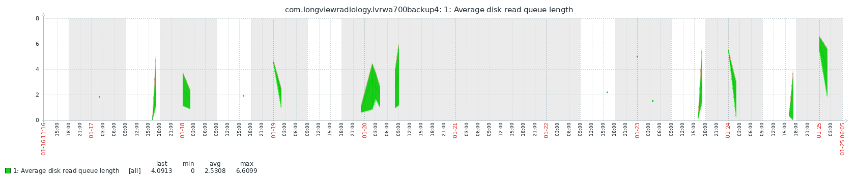

      I think these phantom drives may be temporary drive images, possibly created by BackupExec. There are many errors in the Windows System log that appear to be benign but may shed some light on this. They are "FilterManager" errors, Eveng ID: 3, that look like this:
      "Filter Manager failed to attach to volume '\Device\Harddisk1\DR437'. This volume will be unavailable for filtering until a reboot. The final status was 0xC03A001C."
      Also, Disk Manager does not show these volumes. The Zabbix graphs show they are on line intermittently, then go away. See image. The question is how to get Zabbix to ignore these.
