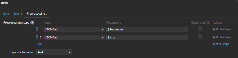

                      Preprocessing failed for: [{"basename":"[...]","pathname":"[...]","dirname":"[...]
                      1. Failed: cannot extract value from json by path "$.basename": no data matches the specified path
                      Click image for larger version  Name:	image.png Views:	0 Size:	17.3 KB ID:	494058
                      What I do wrong?
                      JSON is like above in previous post, but many accumulated so
                      [JSON,JSON,JSON]
                      • z0nk
                        • Oct 2024
                        • 45
                        Ok I found - need double dot on begin: $..basename etc, because of this accumulation:

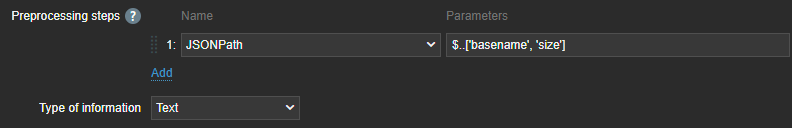

                        When I have
                        Click image for larger version  Name:	image.png Views:	0 Size:	8.3 KB ID:	494062
                        then reasults are:
                        [2518876,"<filename there>",16177428,"<filename there>",[...]
                        is possible to do size in MB/GB unit?
                        • ISiroshtan
                          ISiroshtan commented
                          Easily - no
                          In a bit complicated way? - Add extra pre-processing step of javascript type and write a code to parse the sting, do the conversion and then return desired result.
