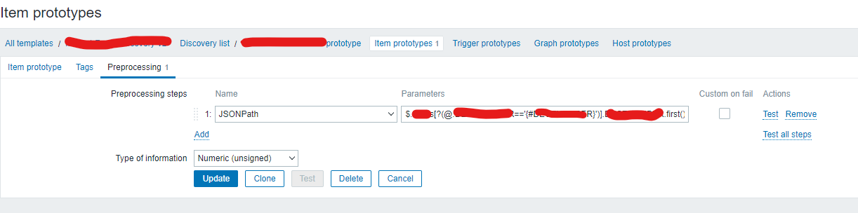

          When you have something like this in host prototype:
          However a step which is easy to forge(also part of the host prototype: Click image for larger version  Name:	image.png Views:	0 Size:	9.5 KB ID:	477049
          And in the template selected (just cut of the screenshot) it's just like any other host-template:
          -above is host prototype---
          When you want value in item prototype:
ID:	477051​Use the pre-processing to find the value, keep in mind the ' next to the == and at the and of the macro (and yes it can be a puzzle to setup the correct jsonpath.
          But you have to provide full path of the entire jsondata.
