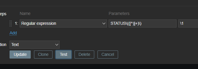

    The ITEM returns the following line:
    QMNAME(rsdcapjboss01) STATUS(Running)
    and in Preprocessing I want to use a regular expression to extract only the word that is inside the second parenthesis "Running"
    I tried different ways but it only accepts the following regex "(STATUS\([^\)]*\))" which should get what I need but extracts "STATUS(Running)" instead of "Running".
    I try several ways but it shows me the error "I am receiving this invalid parameter ""/1/params/1": invalid regular expression."

    Using "STATUS\(([^)]+)\)" shows the error

    STATUS\((.*)\)
    and first capture group \1

      • XxSoulDarkxX
        • Dec 2023
        • 14
        Originally posted by Hamardaban
        STATUS\((.*)\)
        Thanks, it worked, but I would like to know why some regular expressions that should work don't work.
        Is there any specification that needs to be kept in mind to use some regular expressions?​
        • Hamardaban
          • May 2019
          • 2714
          Perl Compatible Regular Expressions (PCRE, PCRE2) are supported in Zabbix​dd
          all information at https://www.zabbix.com/documentation...sions?hl=regex
