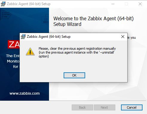

              I am facing another issue while installing zabbix agent they saying you already installed the pervious version . i uninstall it and deleted all file still facing a error . i try the method to uninstall by using the cli but it not found in program history
              • vijayk
                • May 2023
                • 305
                You can run the command zabbix_agent.exe -uninstall in cmd to clean uninstall.
                • Nasir Raza
                  • Jan 2024
                  I tried many methods of uninstalling but no one works. i also tried the above method of "command zabbix_agent.exe -uninstall " but it give error zabbix_agent.exe' is not recognized as an internal or external command,. can you tell me any other method
                  • vijayk
                    • May 2023
                    • 305
                    Is folder exist in Program File?
                    Try to install the same version as before and then uninstall it with command.

                    • Nasir Raza
                      • Jan 2024
                      i did not know which version i installed . is there any method to know which version i installed .because i tried many version after facing the problem
                      • vijayk
                        • May 2023
                        • 305
                        Not sure about how to find older installed version.
