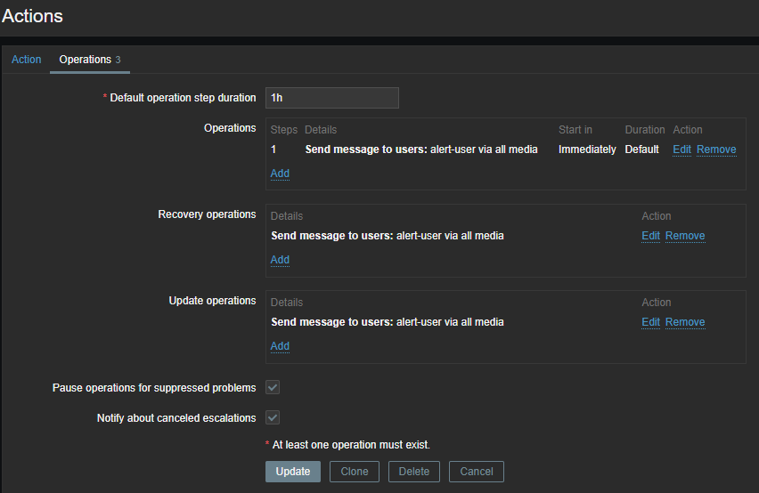

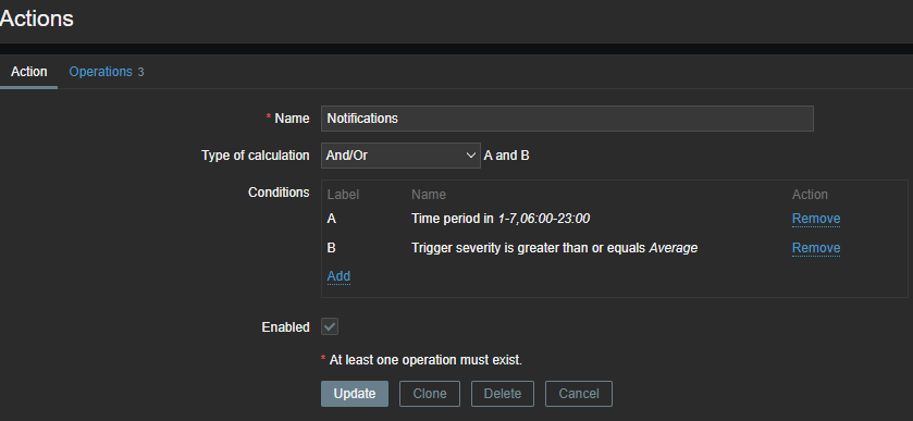

    Actions configuration:

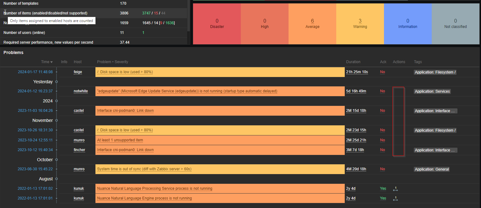

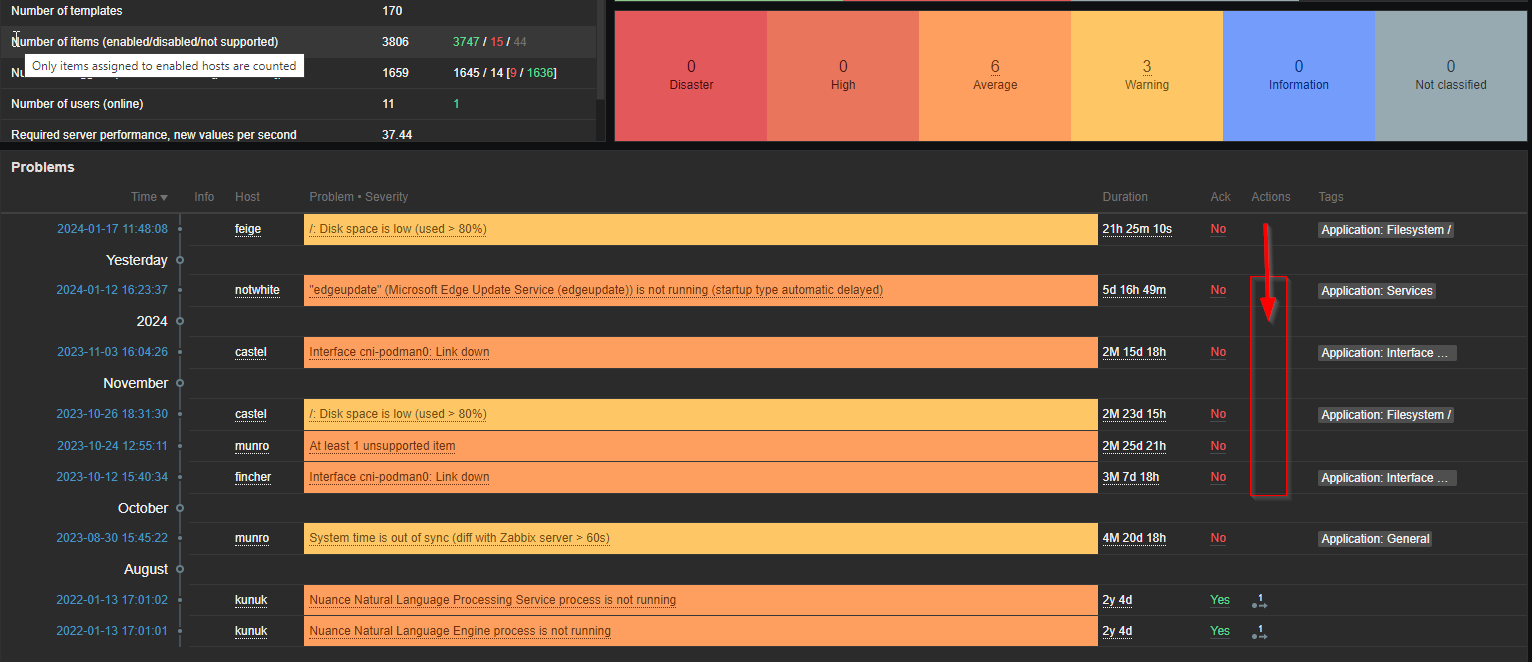

    Yet we can see that many "Average" severity alerts did not trigger the action. And I can confirm that I have validated that some were triggered during the correct period (6:00 - 23:00)
    Tried to look in the server logs for errors but didn't find anything​. As I sait actions will sometimes gets triggered correctly.
    • 4993
    Does that alert-user have access to those hosts (castel, munro etc which seem to not trigger action)...
    • fleroux514
      • Jan 2024
      Totally forgot that `alert-user` needed permissions on those host groups!
