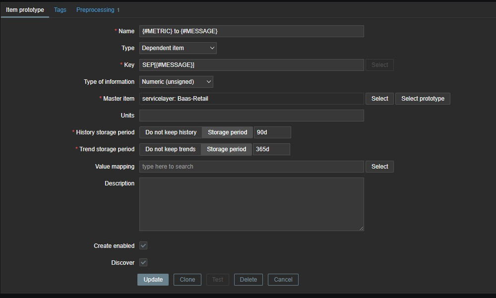

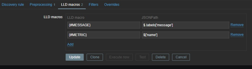

    Also I have attached LLD macros and item prototype and follow is preprocessing in itme_prototype :
    {#METRIC}{Message="{#MESSAGE}"}
    This does not work and I am not sure what is the issue ?

        part of my issue solved with change preprocessing to : baas_retail_Samat_service_total{exception=~".*is not available due to the reason : Message ID:.*"}
        but it is showing follow error for that discovery rule
        Cannot create item: invalid value for preprocessing step #1: invalid pattern: {#METRIC}{Message="{#MESSAGE}"}.
        Also my item prororype name : samat {#EXCEPTION} , key : SEPAM[{#NAME}.{#EXCEPTION}]
        Also preprocessing for prometheus pattern is {#METRIC}{Message="{#MESSAGE}"}
