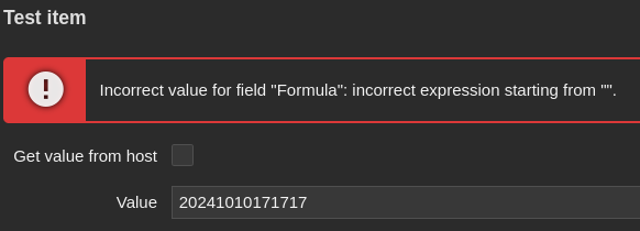

      In my previous example, the input value is a string, and it's not a macro, so I can't use the "fmttime" function.
      The "Date()" function accepts strings as input, but only in date-time string format. It usually requires the ECMAScript format as input and support for other formats is not guaranteed. Implementations are allowed to support other date formats, but I believe the Ducktape implementation used on Zabbix does not support the string I suggested earlier.
      Therefore, using your suggested script results in an error.
      Click image for larger version  Name:	Screenshot from 2024-10-10 18-21-21.png Views:	0 Size:	15.8 KB ID:	492607
