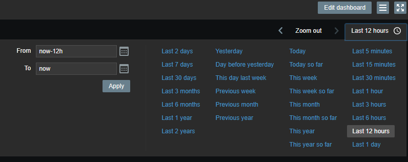

      currently i set the timeframe for each graph, on the dashboard i dont see an option to change it globally to all sub graphs
    • 4993
    umm.. right upper corner...

      I see that in the right upper corner of all my dashboards except the one titled 'Global view'. Is there a way to get it on that dashboard too, or is that one somehow special?
      EDIT: Answering my own question. At least one widget has to be set to use 'dashboard' as its time period.
