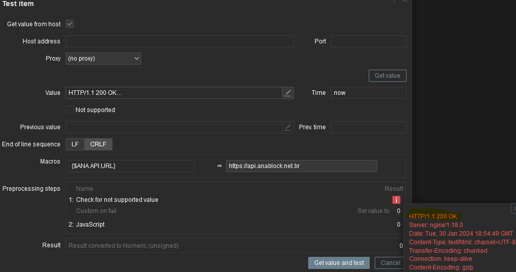

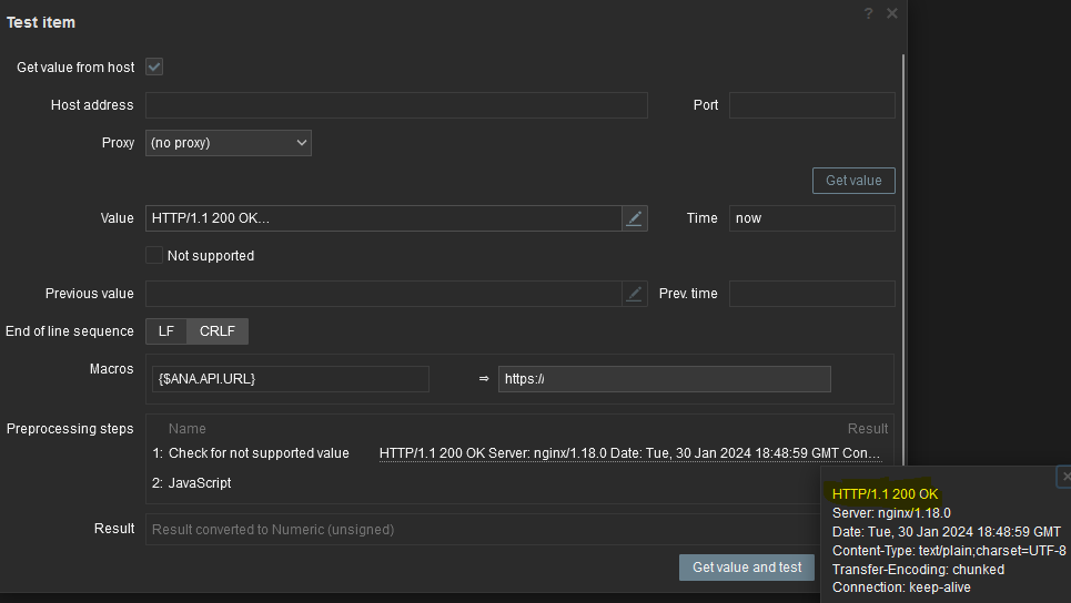

          I think I understand what you mean, but I'm not sure it is this case.
          You see... If I test the HTTP item and switch the "Retrieve mode" to "Headers", we can see the return code.
          If Zabbix successfully retrieves the data, the HTTP item will receive the code 200.​
          Click image for larger version  Name:	ana_content_200.png Views:	0 Size:	30.6 KB ID:	478030​
          If the HTTP item receives an empty response, the HTTP code will also be 200 and​ the item will still be unsupported.​
          Click image for larger versionName:	ana_empty_200.pngViews:	0Size:	31.4 KBID:	478031​
          Now, imagine if the return code was 404 or something else, the preprocessing step would also bypass the error.

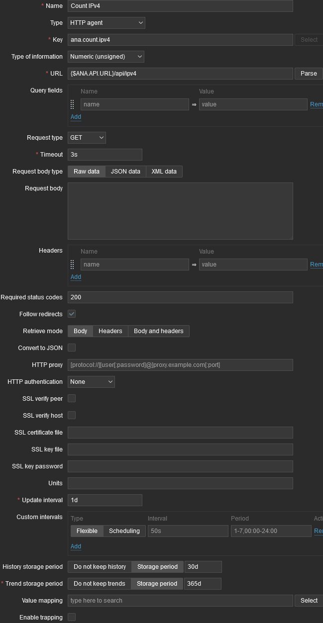

              It's just a simple HTTP Get with no other checks.
              Click image for larger version  Name:	Screenshot 2024-01-31 at 18-58-04 Zabbix Pi Configuration of items.png Views:	0 Size:	52.5 KB ID:	478118​
