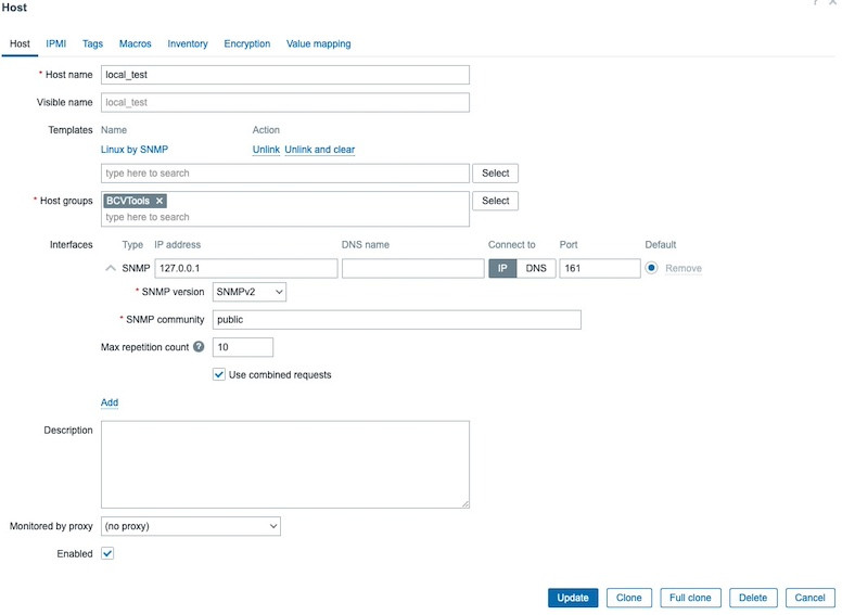

        Can you show the host configuration for "local_test" (I only care about the "Host" tab, not IPMI/Tags/Inventory/etc.)?
        Can you show the item configuration for "LinkUp test"? I only care about the main "Item" tab, not the Tags/Preprocessing tabs.​
        As far as anything from Monitoring > Problem, nothing shows up there. I just see the trap information in the logs. I am convinced my issue is with the Trigger configuration, just unsure of the expression configuration from the documentation to make incoming traps appear on Dashboards.
Name:	Screenshot 2024-02-01 at 6.23.13 AM.jpg
Name:	Screenshot 2024-02-01 at 6.22.37 AM.jpg
